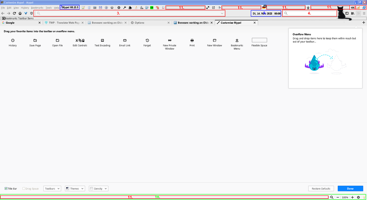

Ascii2 Posted April 10, 2024 Posted April 10, 2024 On 11/16/2023 at 12:16 PM, AstroSkipper said: Here are two screenshots to show where and by what means modifications have been done to the user interface of Mypal 68.13.5b: The colours of the areas mean how the modification was made. Red stands for CSS only, blue for JavaScript only, and green for both, JavaScript + CSS. Cheers, AstroSkipper On 11/17/2023 at 5:23 AM, AstroSkipper said: In Firefox 4, the status bar was replaced with the add-on bar, an empty, but customizable, toolbar. In Firefox 29, Mozilla decided to rework the UI again, and ended up in removing the add-on bar as well. From Firefox 29 to 56, the add-on bar could be restored by the extensions Status-4-Evar or Classic Theme Restorer. Mypal 68 is based on the code of Firefox 68esr, called Firefox Quantum, where no add-on bar can be found or natively be enabled by the user. Therefore, I have been looking for ways to reimplement such a status or add-on bar in Mypal 68 with the functionality to display currently loading URLs and hovered links and to place toolbar buttons there. I finally managed to do this and now I have my status bar again like in the old days. The implementation was done by JavaScript and CSS. Here is a screenshot: Cheers, AstroSkipper It appears that you added an extra toolbar to Mypal 68.x to add a statusbar-like area. I also wanted to add a toolbar. Rather, a few toolbars: (1) one for most the various browser buttons, and (2) a statusbar. You stated that you implemented your statusbar using Javascript and Cascading Style Sheet combination. Did you rely on a startup auto-configuration script to do so? What other things do you think are worth noting?
AstroSkipper Posted April 10, 2024 Author Posted April 10, 2024 (edited) 22 hours ago, Ascii2 said: It appears that you added an extra toolbar to Mypal 68.x to add a statusbar-like area. Not only does it seem that way, but I have definitely implemented a toolbar as a status bar in Mypal 68 with the functionality to display currently loading URLs and hovered links and to place toolbar buttons there as you can see in my previously posted pictures. 22 hours ago, Ascii2 said: I also wanted to add a toolbar. Rather, a few toolbars: (1) one for most the various browser buttons, and (2) a statusbar. You stated that you implemented your statusbar using Javascript and Cascading Style Sheet combination. Did you rely on a startup auto-configuration script to do so? What other things do you think are worth noting? To achieve this, only two files are required, a JavaScript uc.js file in the chrome profile folder and a corresponding Cascading Style Sheet css file in the chrome/css subfolder. The css file must then of course be integrated into the userchrome.css file. The prerequisite for all this is, of course, the preparations that must be made once in order to be able to load scripts and css files from the chrome folder into Mypal 68 as described by me in the first post of this thread. So, I do not use a startup auto-configuration script. You only need, for example, my package MYPAL_68_CB_requirements.7z from the first post. And to implement an additional toolbar near the navigation bar for placing buttons, you only need one other JavaScript uc.js file. In general, the implemetation of a new toolbar can only be done by a JavaScript uc.js file and any styling of it if necessary or desired by a css file. Such changes of the browser interface cannot be done by webextensions due to their damn restrictions. I actually wanted to write an article about all of this long ago, but refrained from doing so due to a lack of interest. Logically, disinterest and passivity are not particularly motivating. Anyway! When I am back at my desktop computer, I can give you more information if you are still interested in. Cheers, AstroSkipper Edited April 11, 2024 by AstroSkipper Update of content 4

AstroSkipper Posted April 10, 2024 Author Posted April 10, 2024 (edited) 21 hours ago, NotHereToPlayGames said: Are you using "window.status"? No, I do not use the property window.status. The script code for creating such a status bar has not grown out of my own hands, though. I simply took over an old script which is still working in Mypal 68. TBH, there are a couple of scripts but most of them are not compatible with Mypal 68. My part was finding working code. And that wasn't so easy due to the age of Firefox 68. Many scripts targeting this Firefox version have been lost or replaced by newer ones. However, I modified the css file for exact placing the status panel onto the status bar by myself. And the css file I am using is much more modified and exactly adapted to my browser, in which I also made changes to the interface font. This file is therefore useless for other users. Edited April 11, 2024 by AstroSkipper Update of content 6
Ascii2 Posted April 12, 2024 Posted April 12, 2024 (edited) On 4/10/2024 at 4:49 AM, AstroSkipper said: I have definitely implemented a toolbar as a status bar in Mypal 68 with the functionality to display currently loading URLs and hovered links and to place toolbar buttons there as you can see in my previously posted pictures. To achieve this, only two files are required, a JavaScript uc.js file in the chrome profile folder and a corresponding Cascading Style Sheet css... So, I do not use a startup auto-configuration script. You only need, for example, my package MYPAL_68_CB_requirements.7z from the first post. And to implement an additional toolbar near the navigation bar for placing buttons, you only need one other JavaScript uc.js file. Thank you for the information. I would note, however, that after examining your MYPAL_68_CB_requirements.7z package, a startup auto-configuration script is indeed used. The defaults/prefs directory defines startup preference overrides and sets a (also startup) configuration script "config.js". For reference, some documentation of the functionality may be found at https://bugzilla.mozilla.org/show_bug.cgi?id=222973 . Also note its attachment at https://bugzilla.mozilla.org/attachment.cgi?id=152002 . On 4/10/2024 at 4:49 AM, AstroSkipper said: In general, the implemetation of a new toolbar can only be done by a JavaScript uc.js file and any styling of it if necessary or desired by a css file. I do note code or know the details of the Javascript language; however, it is my understanding that styling can also be done in Javascript. While it might be possible to implement styling in Javascript, it is my understanding that browsers will tend to handle the CSS faster than the Javascript; it may be more efficient at runtime to use a Javascript and, where styling is desired, Cascading Style Sheet(s). Edited April 12, 2024 by Ascii2
AstroSkipper Posted April 12, 2024 Author Posted April 12, 2024 (edited) 5 hours ago, Ascii2 said: Thank you for the information. You're welcome! 5 hours ago, Ascii2 said: I would note, however, that after examining your MYPAL_68_CB_requirements.7z package, a startup auto-configuration script is indeed used. The defaults/prefs directory defines startup preference overrides and sets a (also startup) configuration script "config.js". For reference, some documentation of the functionality may be found at https://bugzilla.mozilla.org/show_bug.cgi?id=222973 . Also note its attachment at https://bugzilla.mozilla.org/attachment.cgi?id=152002 . This is what I understand by the term autoconfiguration: https://support.mozilla.org/en-US/kb/customizing-firefox-using-autoconfig My package MYPAL_68_CB_requirements.7z contains configuration files as the prerequisite for loading script and css files. Although these files are loaded automatically when starting the browser, the creators of these configuration files do not use the term autoconfiguration at this point. This is merely a question of defining the term. Edited April 12, 2024 by AstroSkipper 3
AstroSkipper Posted April 12, 2024 Author Posted April 12, 2024 (edited) 5 hours ago, Ascii2 said: I do note code or know the details of the Javascript language; however, it is my understanding that styling can also be done in Javascript. While it might be possible to implement styling in Javascript, it is my understanding that browsers will tend to handle the CSS faster than the Javascript; it may be more efficient at runtime to use a Javascript and, where styling is desired, Cascading Style Sheet(s). I do know that CSS styling can also be done inside a JavaScript file. But separating the CSS code in a css file is the usual way when loading files from the chrome folder. Doing so the different CSS styles can be easily enabled or disabled and therefore managed by the userchrome.css file regardless of the script files. Edited April 12, 2024 by AstroSkipper Update of content 2
