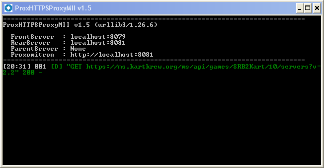

AstroSkipper Posted February 4, 2023 Author Posted February 4, 2023 (edited) @Snowshoe! However, the address https://ms.kartkrew.org/ms/api/games/SRB2Kart/10/servers?v=2.2 exists and can be accessed by IE8 while running ProxHTTPSProxy: ProxHTTPSProxy's log is fine, no errors: Cheers, AstroSkipper Edited February 4, 2023 by AstroSkipper Update of content 2

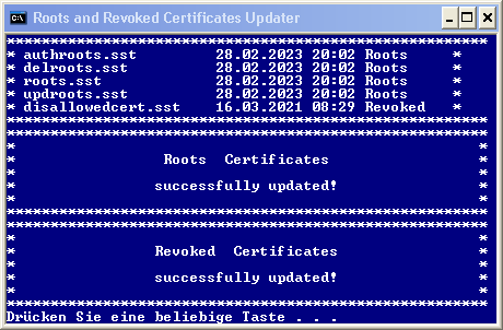

AstroSkipper Posted March 1, 2023 Author Posted March 1, 2023 Update notification! The Root Certificates have been updated and are now from 28-02-2023. Here is a screenshot: Therefore, my self-created, offline Root Certificate Updaters in the section 11.2.4. Downloads related to Root Certificate Updates (in the first post of this thread) will also be updated as soon as possible. Cheers, AstroSkipper 2
AstroSkipper Posted March 4, 2023 Author Posted March 4, 2023 (edited) On 3/1/2023 at 1:44 PM, AstroSkipper said: Update notification! The Root Certificates have been updated and are now from 28-02-2023. Here is a screenshot: Therefore, my self-created, offline Root Certificate Updaters in the section 11.2.4. Downloads related to Root Certificate Updates (in the first post of this thread) will also be updated as soon as possible. Cheers, AstroSkipper Update notification! Both versions of my Root Certificate and Revoked Certificate Updater for offline use have been updated and are now of 02/28/2023. You can find them in the section 11.2.4. Downloads related to Root Certificate Updates in the first post of this thread. Cheers, AstroSkipper Edited March 4, 2023 by AstroSkipper 2
