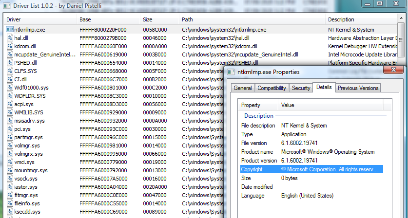

ntkrnlmp.exe is available again, as I have managed to make it work.
What's different about it?
-New section added at end of file
-Export table moved to this section
-Version number changed to 6.1.6002.19741
What was breaking it in the first place? Rebuilding its PE Header. The same thing happens on XP x64. Just update the checksum and you'll be fine.
Once again, I wonder how the version change will affect newer drivers.
For brevity, here are the installation instructions:
I will start patching it accordingly, and hope to bring ntdll in the fold soon. Both ntdll and kernel32 may also be bumped to version 6.1, as it appears that some Qt 5.10+ binaries like to not load after a version check.

28 minutes ago, asdf2345 said:
Will try on my Ryzen system.
Don't know if I'm temporarily more lucky, but Vista appears more stable now.
