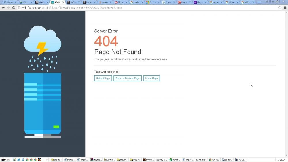

windows2 Posted May 18, 2020 Author Posted May 18, 2020 Please links of Extended Core and UMDF 1.0 I looked for them a lot and did not find
win32 Posted May 18, 2020 Posted May 18, 2020 2 hours ago, windows2 said: Please links of Extended Core and UMDF 1.0 I looked for them a lot and did not find It appears that BWC hasn't actually uploaded KB979683 (Extended Core) to his site, so here is the latest English version: http://web.archive.org/web/*/http://w2k.flxsrv.org/cgi-bin/dl.cgi?file=Windows2000-KB979683-v16a-x86-ENU.exe You can get UMDF 1.0 by opening a Windows Media Player 11 installer with 7zip and extracting umdf.exe from it. Unfortunately I haven't found a way to get that hotfix to work with Windows 2000 yet.
