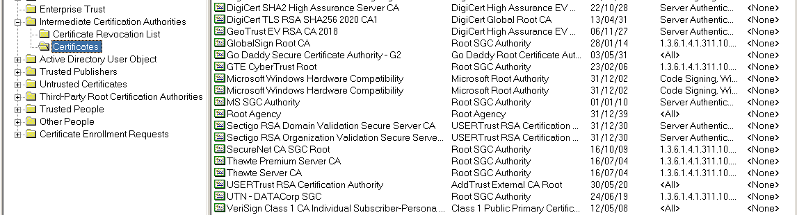

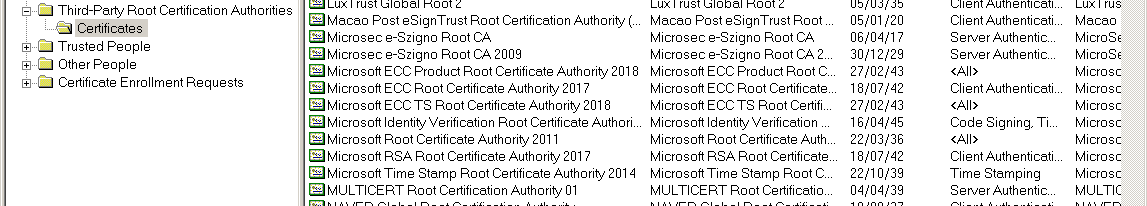

AstroSkipper Posted February 2, 2022 Posted February 2, 2022 (edited) @Dave-H Ok, thanks for further details! I have compared our lists of certificates intently. If you had compared our lists of certificates intently too you would have realized that only one of them is identical. And that is the list of certificates referring to Microsoft in Third Party Root Certification Authorities. But in my list of Intermediate Certification Authorities I have 8 certificates referring to Microsoft and you only 3. Have a look! That's a big difference. If wanted I can upload these missing certificates via PM so that you can import them under Intermediate Certification Authorities. As I told you two posts above expired certificates can still be required and in use too. At last I have analyzed your Windows Update Log once again. Here the interesting lines: 2022-02-01 22:53:27:781 1856 9b0 PT +++++++++++ PT: Synchronizing server updates +++++++++++ 2022-02-01 22:53:27:781 1856 9b0 PT + ServiceId = {7971F918-A847-4430-9279-4A52D1EFE18D}, Server URL = https://fe2.update.microsoft.com/v6/ClientWebService/client.asmx 2022-02-01 22:53:28:796 1856 9b0 Misc WARNING: Send failed with hr = 80072f8f. 2022-02-01 22:53:28:796 1856 9b0 Misc WARNING: SendRequest failed with hr = 80072f8f. Proxy List used: <https=localhost:8080> Bypass List used : <<local>> Auth Schemes used : <> 2022-02-01 22:53:28:796 1856 9b0 PT + Last proxy send request failed with hr = 0x80072F8F, HTTP status code = 0 . . . 2022-02-01 22:53:28:796 1856 9b0 PT WARNING: GetConfig failure, error = 0x80072F8F, soap client error = 5, soap error code = 0, HTTP status code = 200 2022-02-01 22:53:28:796 1856 9b0 PT WARNING: PTError: 0x80072f8f 2022-02-01 22:53:28:796 1856 9b0 PT WARNING: GetConfig_WithRecovery failed: 0x80072f8f 2022-02-01 22:53:28:796 1856 9b0 PT WARNING: RefreshConfig failed: 0x80072f8f 2022-02-01 22:53:28:796 1856 9b0 PT WARNING: RefreshPTState failed: 0x80072f8f 2022-02-01 22:53:28:796 1856 9b0 PT WARNING: Sync of Updates: 0x80072f8f 2022-02-01 22:53:28:796 1856 9b0 PT WARNING: SyncServerUpdatesInternal failed: 0x80072f8f 2022-02-01 22:53:28:796 1856 9b0 Agent * WARNING: Failed to synchronize, error = 0x80072F8F 2022-02-01 22:53:28:796 1856 9b0 Agent * WARNING: Exit code = 0x80072F8F As we already know Microsoft Update 0x80072f8f error code means ERROR_INTERNET_SECURE_FAILURE ErrorClockWrong. What does it really imply in your case? You can see it in your Windows Update Log. Look at bold text! A client fails to contact its server. In your case client is your computer and server is Microsoft Update Server. Request sent from your computer to MU failed. Synchronizing of client and server failed. Getting configurations failed. That' your problem. What is the conclusion? The connection and synchronization failures between client and server have to be fixed. At first we have to think about what we've already restored and fixed. The Windows Update Agent looks fine and you have reported that all steps of my post "Manually reset Windows Update components (KB971058)" have been performed: Have you performed step 4 too or have you skipped it as recommended? Quote If this is your first attempt at resolving your Windows Update issues by following the steps in this article, you should skip step 4 and go to step 5. If you skipped step 4 then it should be catched up. Furthermore I added another registering of a DLL component: in step 6: Quote And the following added by me (@AstroSkipper): regsvr32.exe mssip32.dll Perform this registering to complete step 6. Now some settimgs: Go to IE Internet Options, Advanced and click to select the Use HTTP 1.1 and the Use HTTP 1.1 through proxy connections check boxes if not already selected. Next check if system service HTTP-SSL has system been started. If not start it and set it to Auto Start. Now reboot your computer, try to access MU again and post your Windows Update Log. If these tips don't solve the problem I have another one: Change your DNS servers to Cloudflare or Google and check if it helped. I use often DNS servers of Cloudflare but at the moment the servers of my provider. So far from me today! Edited February 3, 2022 by AstroSkipper addition 2
