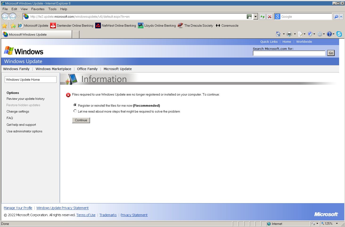

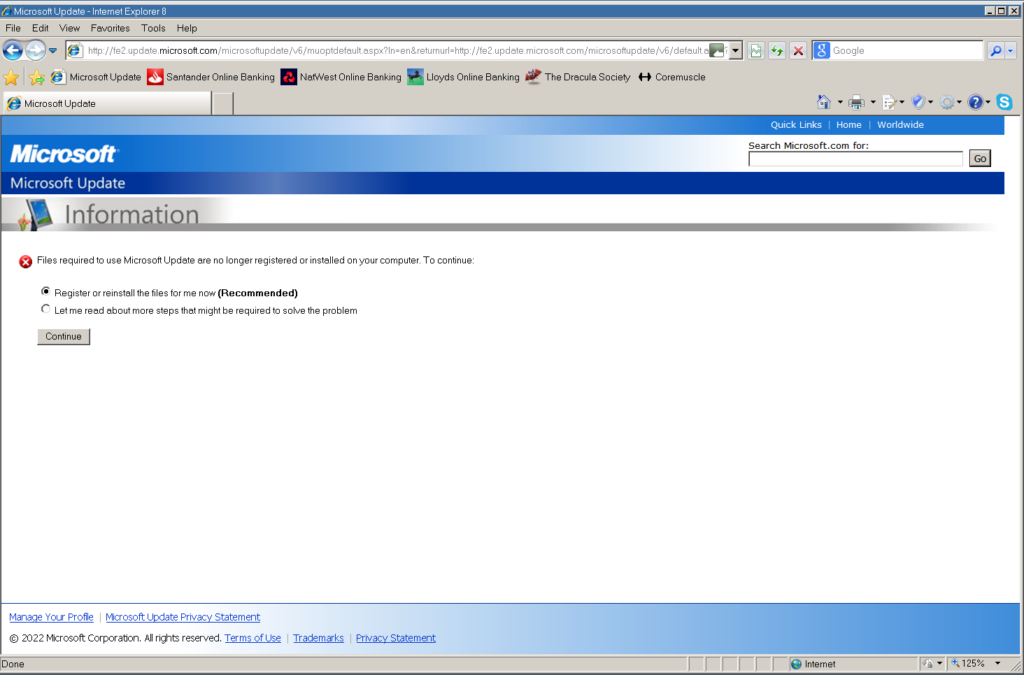

Dave-H Posted January 27, 2022 Posted January 27, 2022 Thanks, that's better. I was now prompted to switch to Microsoft Update, but when i did it said the necessary files weren't registered and offered to do it for me. If I click continue, the window goes blank but nothing then appears to happen.
maile3241 Posted January 27, 2022 Posted January 27, 2022 5 minutes ago, Dave-H said: Thanks, that's better. I was now prompted to switch to Microsoft Update, but when i did it said the necessary files weren't registered and offered to do it for me. If I click continue, the window goes blank but nothing then appears to happen. Register muweb.dll again with regsvr32 then reload the page.
Dave-H Posted January 27, 2022 Posted January 27, 2022 I tried that, and registering wuaueng.dll. No difference.

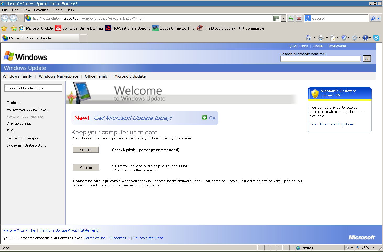

Dave-H Posted January 27, 2022 Posted January 27, 2022 17 minutes ago, maile3241 said: Try Windows Update: http://fe2.update.microsoft.com/windowsupdate/v6/default.aspx?ln=en Windows Update looks more promising. Scanning immediately produces the same error though.
maile3241 Posted January 27, 2022 Posted January 27, 2022 5 minutes ago, Dave-H said: Windows Update looks more promising. Scanning immediately produces the same error though. Run Restore_WU_XP_2003 again.

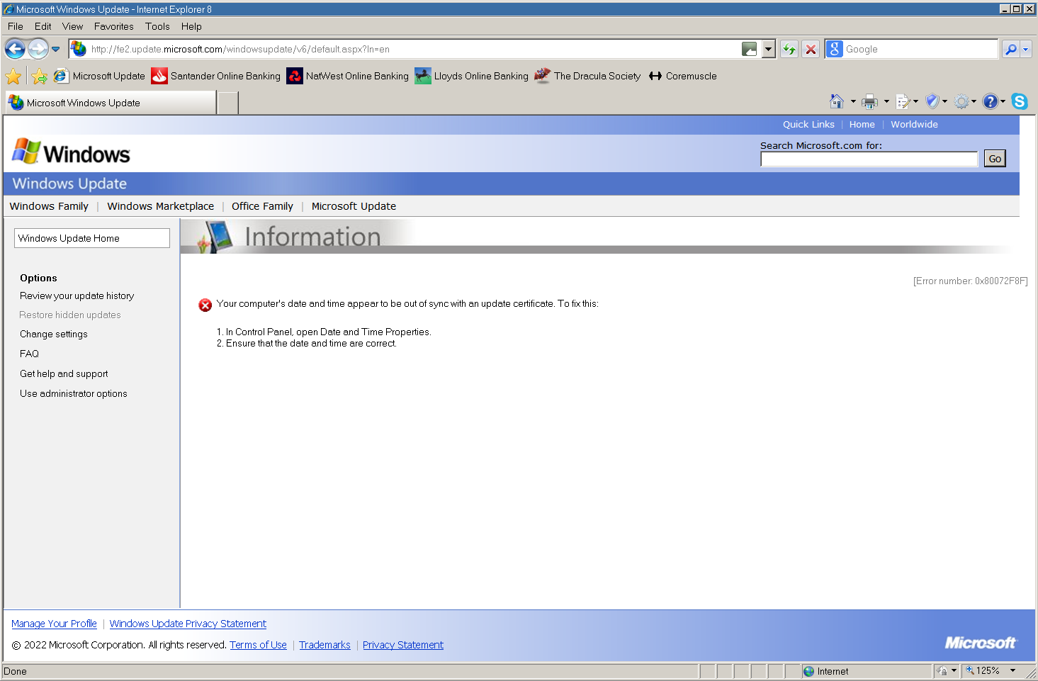

Dave-H Posted January 27, 2022 Posted January 27, 2022 OK, I ran the cmd file again, and got this. Presumably this is because the cmd didn't stop the Automatic Updates service. I assume the file manipulation should happen on reboot. It has made a difference, on reboot, trying Windows Update again gave this again!
maile3241 Posted January 27, 2022 Posted January 27, 2022 8 minutes ago, Dave-H said: OK, I ran the cmd file again, and got this. Presumably this is because the cmd didn't stop the Automatic Updates service. I assume the file manipulation should happen on reboot. It has made a difference, on reboot, trying Windows Update again gave this again! Try restoring the default values. Then activate Tls 1.2 again.
