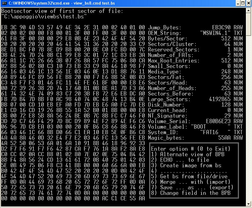

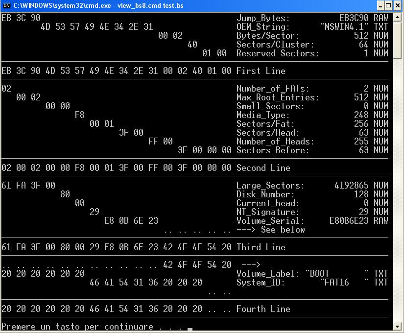

jaclaz Posted November 3, 2017 Posted November 3, 2017 1 hour ago, rloew said: ... but for reasons I don't know, it also allows 0x49. Good to know 0x49 should be "dec ecx" quite "strange". 1 hour ago, rloew said: I never used FreeDOS or IMDISK. In this case IMDISK is just some means to mount a volume easily, the mechanism involved and the results of the experiments came/come from the "standard" XP detecting/mounting. @98SE Just to show off a bit find attached the output of the batch you can find here: http://www.msfn.org/board/topic/152097-on-superfloppies-and-their-images/?do=findComment&comment=1001712 on "your" last posted bootsector (please note that it is designed to work ONLY for FAT12 or 16 bootsectors). jaclaz
