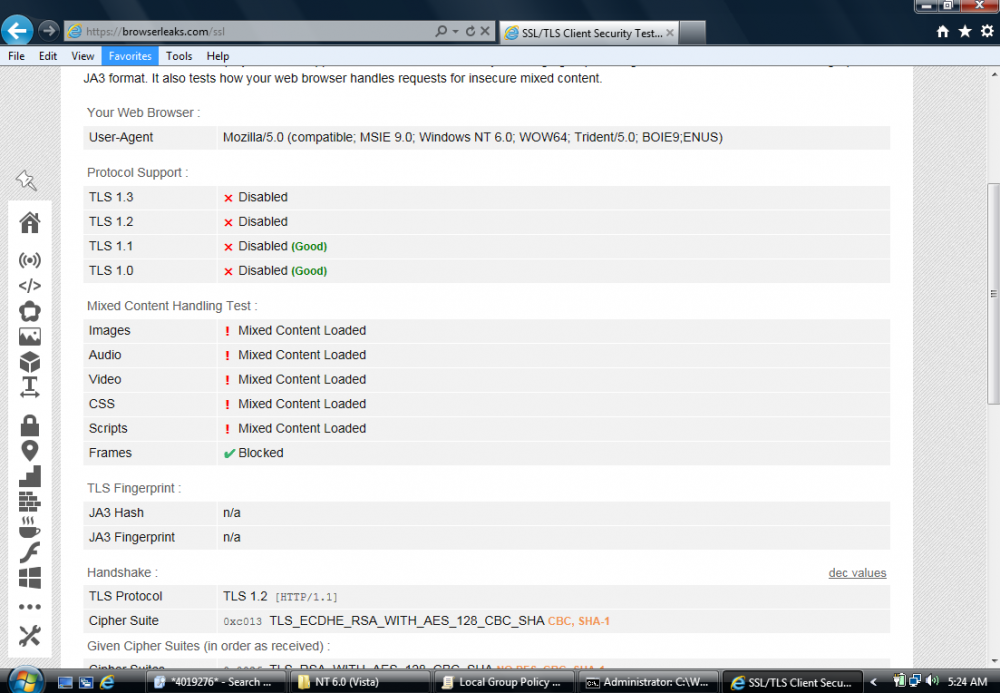

InterLinked Posted August 8, 2020 Posted August 8, 2020 (edited) @VistaLover @Vistapocalypse @win32 OK, so something bizarre is definitely going on, Not sure if it had to do with the reg patches I applied. In Local Group Policy, I do have the option to "Use TLS 1, 1.1, 1.2 only". I toggled that on and off and it seemed to have no effect. However, I navigated to a site I know is TLS 1.2+ only and it worked! Confused, I ran a client SSL test - these were the results: This matches with Internet options - SSL 2, 3, and TLS 1 are disabled/greyed out AND I don't have any of them checked! How is HTTPS even working? It seems there is a huge mismatch between the settings and what's really going on... ???? I played with the group policy settings and they do seem to do SOMETHING... when I changed it to "Use TLS 1.1 only", the aforementioned site stopped working. When I changed it back to 1, 1.1, and 1.2 only, it started working again. So I guess TLS 1.2 DOES work, but it's not apparent because the options don't show up in Internet Options. And SSL tests say the protocols are disabled even though it literally says TLS 1.2 for the handshake protocol!!! Any way to fix this? I've run the registry changes multiple times. Edited August 8, 2020 by Dylan Cruz

VistaLover Posted August 9, 2020 Author Posted August 9, 2020 (edited) On 8/8/2020 at 2:26 PM, Dylan Cruz said: And SSL tests say the protocols are disabled even though it literally says TLS 1.2 for the handshake protocol!!! The Protocol Support section of the SSL Client Test available in browserleaks.com also fails for me here in IE9 32-bit: ... while, at the same time, the Handshake section is displayed correctly: Perhaps they're using some CSS/JS code in the first failing section that the deprecated IE9 rendering engine can't cope with... (?) For IE9 specifically, you may want to use the SSL Labs Client Test, https://www.ssllabs.com/ssltest/viewMyClient.html : Edited August 9, 2020 by VistaLover 1

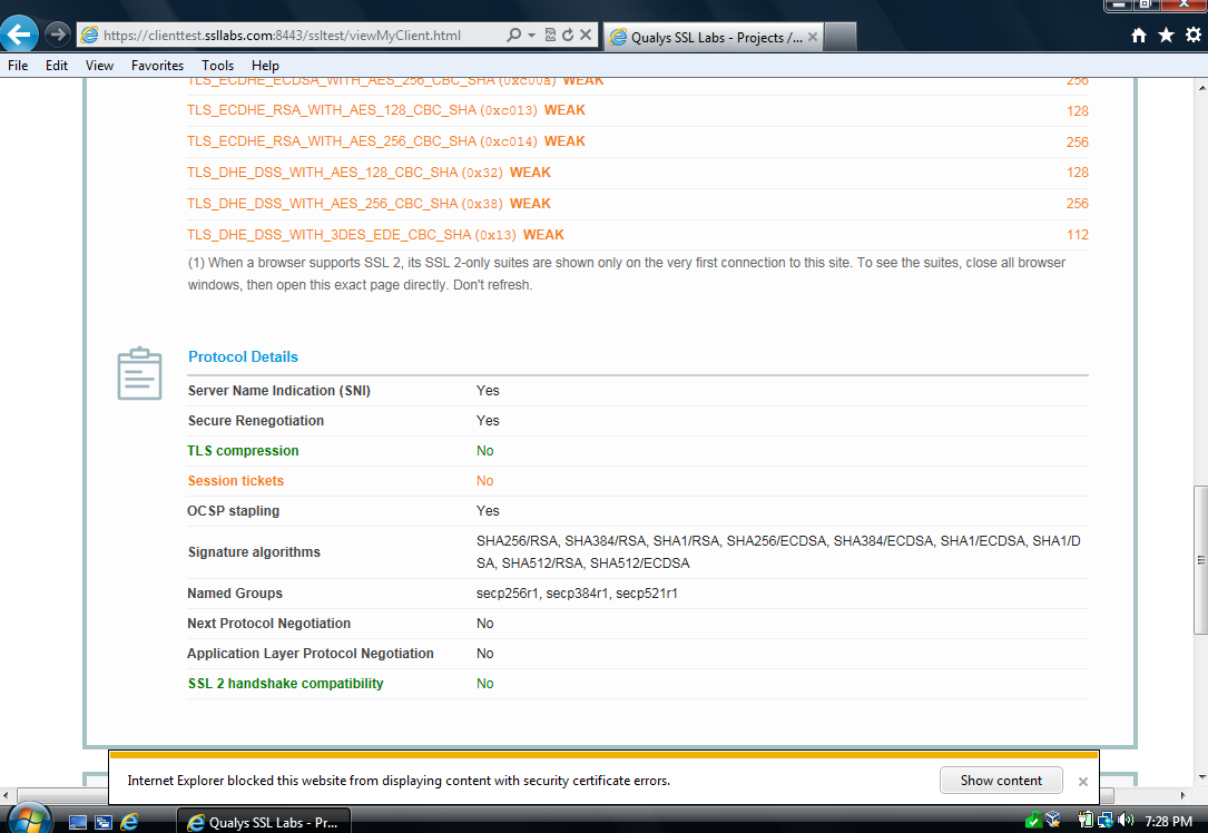

VistaLover Posted August 9, 2020 Author Posted August 9, 2020 (edited) For the more observant among you, you might've noticed that @Dylan Cruz 's last screengrab contains one additional IE9 cipher suite [TLS_DHE_DSS_WITH_3DES_EDE_CBC_SHA (0x13)] that is absent on my IE9 SSL Labs Client Test! In fact, on a TLS 1.0+1.1+1.2 enabled Vista SP2 machine, IE9 supports the below twelve variations of cipher suites: TLS_ECDHE_ECDSA_WITH_AES_128_CBC_SHA (0xc009) Forward Secrecy 128 TLS_ECDHE_ECDSA_WITH_AES_256_CBC_SHA (0xc00a) Forward Secrecy 256 TLS_ECDHE_RSA_WITH_AES_128_CBC_SHA (0xc013) Forward Secrecy 128 TLS_ECDHE_RSA_WITH_AES_256_CBC_SHA (0xc014) Forward Secrecy 256 TLS_DHE_DSS_WITH_AES_128_CBC_SHA (0x32) Forward Secrecy(2) 128 TLS_DHE_DSS_WITH_AES_256_CBC_SHA (0x38) Forward Secrecy(2) 256 TLS_DHE_DSS_WITH_3DES_EDE_CBC_SHA (0x13) WEAK 112 TLS_RSA_WITH_AES_128_CBC_SHA (0x2f) WEAK 128 TLS_RSA_WITH_AES_256_CBC_SHA (0x35) WEAK 256 TLS_RSA_WITH_3DES_EDE_CBC_SHA (0xa) WEAK 112 TLS_RSA_WITH_RC4_128_SHA (0x5) INSECURE 128 TLS_RSA_WITH_RC4_128_MD5 (0x4) INSECURE 128 (2) Cannot be used for Forward Secrecy because they require DSA keys, which are effectively limited to 1024 bits. At some point, I had removed support for half of them, deemed to be extremely WEAK/insecure: Removed: *TLS_RSA_WITH_AES_128_CBC_SHA (0x2f) WEAK 128 (TLS1.1) *TLS_RSA_WITH_AES_256_CBC_SHA (0x35) WEAK 256 (TLS1.1) *TLS_RSA_WITH_3DES_EDE_CBC_SHA (0xa) WEAK 112 (TLS1.2) *TLS_DHE_DSS_WITH_3DES_EDE_CBC_SHA (0x13) WEAK 112 *TLS_RSA_WITH_RC4_128_SHA (0x5) INSECURE 128 *TLS_RSA_WITH_RC4_128_MD5 (0x4) INSECURE 128 which currently leaves me with TLS_ECDHE_ECDSA_WITH_AES_128_CBC_SHA (0xc009) Forward Secrecy 128 TLS_ECDHE_ECDSA_WITH_AES_256_CBC_SHA (0xc00a) Forward Secrecy 256 TLS_ECDHE_RSA_WITH_AES_128_CBC_SHA (0xc013) Forward Secrecy 128 TLS_ECDHE_RSA_WITH_AES_256_CBC_SHA (0xc014) Forward Secrecy 256 TLS_DHE_DSS_WITH_AES_128_CBC_SHA (0x32) Forward Secrecy(2) 128 TLS_DHE_DSS_WITH_AES_256_CBC_SHA (0x38) Forward Secrecy(2) 256 NB: The last two do not support FS, so I might remove them, too... PS: On my 32-bit system I used Disable_RSA_Ciphers_RC4-128-128_3DES-168.reg : Windows Registry Editor Version 5.00 [HKEY_LOCAL_MACHINE\SYSTEM\CurrentControlSet\Control\SecurityProviders\SCHANNEL\Ciphers\RC4 128/128] "Enabled"=dword:00000000 [HKEY_LOCAL_MACHINE\SYSTEM\CurrentControlSet\Control\SecurityProviders\SCHANNEL\Ciphers\Triple DES 168] "Enabled"=dword:00000000 [HKEY_LOCAL_MACHINE\SYSTEM\CurrentControlSet\Control\SecurityProviders\SCHANNEL\KeyExchangeAlgorithms\PKCS] "Enabled"=dword:00000000 A computer restart is needed before these changes take effect! Reference: https://support.microsoft.com/en-us/help/245030/how-to-restrict-the-use-of-certain-cryptographic-algorithms-and-protocols Edited August 9, 2020 by VistaLover 1
InterLinked Posted August 9, 2020 Posted August 9, 2020 12 minutes ago, VistaLover said: For the more observant among you, you might've noticed that @Dylan Cruz 's last screengrab contains one additional IE9 cipher suite [TLS_DHE_DSS_WITH_3DES_EDE_CBC_SHA (0x13)] that is absent on my IE9 SSL Labs Client Test! In fact, on a TLS 1.0+1.1+1.2 enabled Vista SP2 machine, IE9 supports the below twelve variations of cipher suites: TLS_ECDHE_ECDSA_WITH_AES_128_CBC_SHA (0xc009) Forward Secrecy 128 TLS_ECDHE_ECDSA_WITH_AES_256_CBC_SHA (0xc00a) Forward Secrecy 256 TLS_ECDHE_RSA_WITH_AES_128_CBC_SHA (0xc013) Forward Secrecy 128 TLS_ECDHE_RSA_WITH_AES_256_CBC_SHA (0xc014) Forward Secrecy 256 TLS_DHE_DSS_WITH_AES_128_CBC_SHA (0x32) Forward Secrecy(2) 128 TLS_DHE_DSS_WITH_AES_256_CBC_SHA (0x38) Forward Secrecy(2) 256 TLS_DHE_DSS_WITH_3DES_EDE_CBC_SHA (0x13) WEAK 112 TLS_RSA_WITH_AES_128_CBC_SHA (0x2f) WEAK 128 TLS_RSA_WITH_AES_256_CBC_SHA (0x35) WEAK 256 TLS_RSA_WITH_3DES_EDE_CBC_SHA (0xa) WEAK 112 TLS_RSA_WITH_RC4_128_SHA (0x5) INSECURE 128 TLS_RSA_WITH_RC4_128_MD5 (0x4) INSECURE 128 (2) Cannot be used for Forward Secrecy because they require DSA keys, which are effectively limited to 1024 bits. At some point, I had removed support for half of them, deemed to be extremely WEAK/insecure: Removed: *TLS_RSA_WITH_AES_128_CBC_SHA (0x2f) WEAK 128 (TLS1.1) *TLS_RSA_WITH_AES_256_CBC_SHA (0x35) WEAK 256 (TLS1.1) *TLS_RSA_WITH_3DES_EDE_CBC_SHA (0xa) WEAK 112 (TLS1.2) *TLS_DHE_DSS_WITH_3DES_EDE_CBC_SHA (0x13) WEAK 112 *TLS_RSA_WITH_RC4_128_SHA (0x5) INSECURE 128 *TLS_RSA_WITH_RC4_128_MD5 (0x4) INSECURE 128 which currently leaves me with TLS_ECDHE_ECDSA_WITH_AES_128_CBC_SHA (0xc009) Forward Secrecy 128 TLS_ECDHE_ECDSA_WITH_AES_256_CBC_SHA (0xc00a) Forward Secrecy 256 TLS_ECDHE_RSA_WITH_AES_128_CBC_SHA (0xc013) Forward Secrecy 128 TLS_ECDHE_RSA_WITH_AES_256_CBC_SHA (0xc014) Forward Secrecy 256 TLS_DHE_DSS_WITH_AES_128_CBC_SHA (0x32) Forward Secrecy(2) 128 TLS_DHE_DSS_WITH_AES_256_CBC_SHA (0x38) Forward Secrecy(2) 256 NB: The last two do not support FS, so I might remove them, too... PS: On my 32-bit system I used Disable_RSA_Ciphers_RC4-128-128_3DES-168.reg : Windows Registry Editor Version 5.00 [HKEY_LOCAL_MACHINE\SYSTEM\CurrentControlSet\Control\SecurityProviders\SCHANNEL\Ciphers\RC4 128/128] "Enabled"=dword:00000000 [HKEY_LOCAL_MACHINE\SYSTEM\CurrentControlSet\Control\SecurityProviders\SCHANNEL\Ciphers\Triple DES 168] "Enabled"=dword:00000000 [HKEY_LOCAL_MACHINE\SYSTEM\CurrentControlSet\Control\SecurityProviders\SCHANNEL\KeyExchangeAlgorithms\PKCS] "Enabled"=dword:00000000 Reference: https://support.microsoft.com/en-us/help/245030/how-to-restrict-the-use-of-certain-cryptographic-algorithms-and-protocols Does this matter though if SSL2/3 are disabled? What would be the 64-bit reg script? Thanks!
VistaLover Posted August 9, 2020 Author Posted August 9, 2020 (edited) 10 minutes ago, Dylan Cruz said: Does this matter though if SSL2/3 are disabled? Please re-read my actual post! It pertains to insecure/weak cipher suites when ONLY TLS 1.0+1.1+1.2 are enabled! 10 minutes ago, Dylan Cruz said: What would be the 64-bit reg script? I'm sure you've been notified already of the fact I ONLY use the 32-bit variant of the OS, so no clue really... Try using the one I provided and go your way from there; I have faith in you! (FTR, a link to a M$ support article IS provided...) Edited August 9, 2020 by VistaLover
