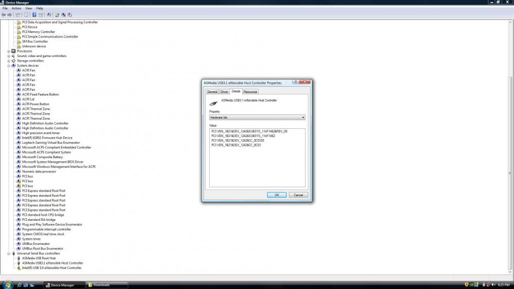

burd Posted January 5, 2017 Author Posted January 5, 2017 13 hours ago, jaclaz said: Usually it is a good idea to use SIV:http://rh-software.com/ to have a detailed overview of all the hardware on a machine, but in your case for just THE VID and PID you just click in device manager on the "Details" tab, then on the dropdown list you choose "Hardware ID", *like*: Hide contents jaclaz Will Hop into Vista and Post in a bit(tough without a mouse)
burd Posted January 5, 2017 Author Posted January 5, 2017 2 hours ago, jaclaz said: Usually it is a good idea to use SIV:http://rh-software.com/ to have a detailed overview of all the hardware on a machine, but in your case for just THE VID and PID you just click in device manager on the "Details" tab, then on the dropdown list you choose "Hardware ID", *like*: Reveal hidden contents jaclaz
burd Posted January 5, 2017 Author Posted January 5, 2017 (edited) 3rd/4th image is here because i cant post due to 1/2mb limithttp://imgur.com/a/ADF3jhttp://imgur.com/a/aibB8 Edited January 5, 2017 by burd

burd Posted January 5, 2017 Author Posted January 5, 2017 13 hours ago, jaclaz said: Well, just copy or type the info. OR, learn to make a limited screenshot, you know, like ALT+PrtScr:https://en.wikipedia.org/wiki/Print_screen#Modern_use jaclaz im not aware of the details you need in specific so ive done this my friend. Getting back to the topic is it possible to find some alternative drivers? just have a look
burd Posted January 5, 2017 Author Posted January 5, 2017 (edited) 13 hours ago, cdob said: http://www.intel.com/content/www/us/en/support/boards-and-kits/000005506.html Intel USB 3.0 eXtensible Host Controller Driver Not Supported in Windows XP or Windows Vista Yes,But Drivers are coded for Vista so its a bit disappointinghttp://download.msi.com/nb_drivers/usb/ASMUSBHost_V116381WHQL.zip Edited January 5, 2017 by burd
jaclaz Posted January 5, 2017 Posted January 5, 2017 Well, if cdob says that Intel xhci is not supported in Vista, that's it. I knew for sure about XP, but evidently that extends to Vista. As a generic rule of the thumb 1/2 to 2/3 of the readme.txt or however info coming from drivers packages and drivers sites is either wrong or obsolete (or both), so NEVER (and I do mean NEVER) trust them at face value. Just in case, what I wanted to know was VID and PID, just 8086/A12F, you don't really need screenshots to provide this info (but of course you need to experiment and learn how to retrieve it ). jaclaz
