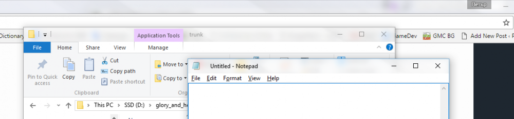

Looks like Anniversary update changed something significant.
Before anniversary I were getting white windows with no theme atlas.
With 1.5, I am always getting colored title bars now, no matter if the "Show color in Titlebar" is checked or not. Looks like I cannot turn off coloring of titlebars now, and I really like the old UI I've got.
There are the screenshots before anniversary update and after it with 1.5 stable.

Yes, there is a change. Win10 TH rendered the frame edge with ColorizationColor and the frame caption with AccentColor (or white), and AeroGlass respected this settings. Win10 RS does the same with difference that it contains some bug which randomly resets ColorizationColor to AccentColor and thus I decided to ignore the system settings and always use AccentColor for the whole frame. It may be changed later.
