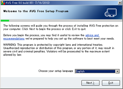

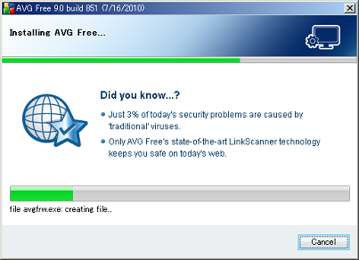

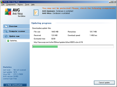

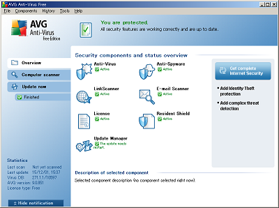

blackwingcat Posted December 1, 2015 Share Posted December 1, 2015 (edited) Here is Extended Kernel v2.6b(GameFix Version) ( It will be released soon).I try to install AVG 9.0. It seems to work fine. Hi. What does it mean?I don't use Vanilla Win 2000. In this context “vanilla” means a standard W2k Pro OS installation running with no unofficial updates and no modifications--and we find that AVG 9 works fine. However, when we try to use AVG 9 with unofficial updates involved, there are problems. Edited December 1, 2015 by blackwingcat Link to comment Share on other sites More sharing options...
