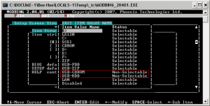

Drugwash Posted June 11, 2014 Posted June 11, 2014 (edited) The BIOS images are available from the official FTP here. Included there is a flashing utility. As far as I can tell, the latest available (3u112) has a few USB-related boot options, but two of them are disabled, namely USB-CDROM and USB-HDD. You may use ModBin 6 and maybe even a version of CBROM (haven't tried any yet) to enable those options. Edited June 11, 2014 by Drugwash

Drugwash Posted June 11, 2014 Posted June 11, 2014 Here's all the boot options for the BIOS revision R1.12 (3u112.zip) - unless the user specifically needs USB-CDROM or USB-HDD boot options enabled, the official BIOS image may be flashed in without any modification and all selectable options should be available. Personally I've flashed some BIOS images from HDD, by letting Win9x boot in DOS mode (F8 during boot -> Command prompt only) and running the flasher from a previously prepared folder in C:, to avoid any floppy issues - your mileage may vary.
