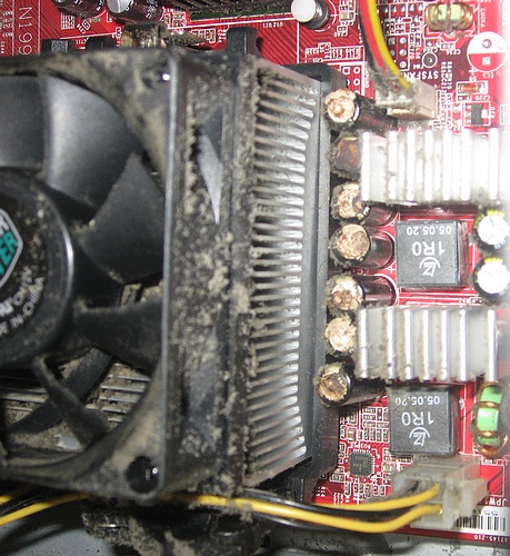

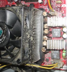

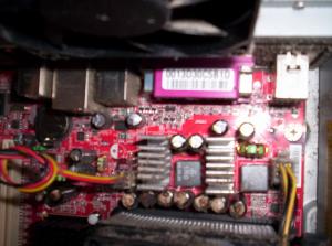

CharlotteTheHarlot Posted March 15, 2014 Posted March 15, 2014 I did a close visual inspection of the motherboard, and I did find something that looks bad. Some serious corrosion, or buildup of stuff on some transistors (?). They're right next to the CPU, they almost look melted or like an exploded battery. There is several of these. All the other ones on the board look shiny and normal. I'll attach a pic in a second. Those are capacitors. The picture is too blurry to be sure but one looks misshapen which is a bad sign for caps. Be aware they usually use a thick glue which is clear or white around caps and some other components to prevent any movement. Some folks mistake this for leaking. Please get a better photo ( you don't need to zoom in, that can be done by us. Instead take a high resolution picture with higher megapixel setting, with the "auto" turned off for longer exposure and no flash. Make sure it is in focus. You need to either hold the camera steady or set it down or use a tripod. ).

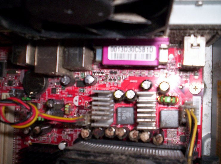

ZortMcGort11 Posted March 15, 2014 Author Posted March 15, 2014 (edited) More pics.In the second picture, compare the capacitor at the top left corner and the ones to right of the CPU. The ones next to the CPU have a corroded hard material on top, while the rest are neat and shiny looking.Computer is an "Emachine T6410." Edited March 15, 2014 by LostInSpace2012
Tommy Posted March 15, 2014 Posted March 15, 2014 Yikes, not good at all. What brand of motherboard is it? Does it say on it? If it came from around the 2003-2005 era, it could've fallen victim to the bad caps produced around that time.
ZortMcGort11 Posted March 15, 2014 Author Posted March 15, 2014 I couldn't see what the motherboard is, but the computer model is "Emachine T6410" which came with XP Sp2.
Kelsenellenelvian Posted March 16, 2014 Posted March 16, 2014 Yeah those are blown, that motherboard is dead.
Tommy Posted March 16, 2014 Posted March 16, 2014 Yeah those are blown, that motherboard is dead.I'm surprised it lasted that long. My Optiplex had two caps just barely even beginning to bulge at the top, nothing was even leaking yet and yet it still died.
CharlotteTheHarlot Posted March 16, 2014 Posted March 16, 2014 More pics.In the second picture, compare the capacitor at the top left corner and the ones to right of the CPU. The ones next to the CPU have a corroded hard material on top, while the rest are neat and shiny looking.Computer is an "Emachine T6410."To be honest it looks like caked dust clinging to the adhesive, but I can't be sure.I would nail that thing with canned air, a lot of it. Be sure to hold the fan blades when spraying the air to stop them from spinning and really clean out around the CPU and caps. And then take a higher resolution photo ( more pixels ), That one is in focus but even zoomed it is inconclusive. I don't see that misshapen cap in the new photo, is was probably an illusion. Just saying it might not be bad.Use your eyeballs ... are those caps leaking with a brownish/blackish goo, or is it just the crud and dust?
jaclaz Posted March 16, 2014 Posted March 16, 2014 Additionally, and NO matter if "clean" (or brownish/blackish, as often it's orangish), are the capacitor tops "flat" or "bulging"?Do any of these have "leakings" at the bottom?See here for some reference images:http://www.markdigital.com/2011/02/14/bad-capacitors-lcd-monitor-repaired/http://www.pcstats.com/articleview.cfm?articleID=195http://www.geeksinphoenix.com/blog/?tag=/hardwarehttp://www.capacitorlab.com/visible-failures/jaclaz
