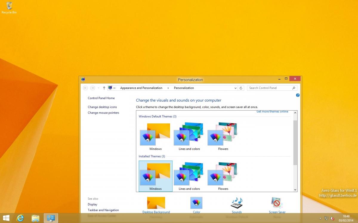

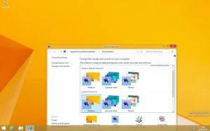

Blurred Taskbar when using Aero Glass for Win8.1 without ANY 3rd PARTY TOOLS.
Basic Idea:
0.Install Take Ownership.
1.Goto C:\Windows\Resources and Take Ownership of Themes folder, now copy Themes folder to desktop.
2.Open Themes folder and rename
aero (folder) TO aero2
aero (.theme) TO aero2
theme1 (.theme) TO theme3
theme2 (.theme) TO theme4
3.Open
aero2 (.theme)
theme3 (.theme)
theme4 (.theme)
With Notepad and find [VisualStyles] / Path=%ResourceDir%\Themes\Aero\Aero.msstyles and change IT TO Path=%ResourceDir%\Themes\Aero2\Aerolite.msstyles
4.Open aero2 folder and delete VSCache folder
5.Open aero2 folder and delete aerolite.msstyles, now rename aero.msstyles TO aerolite.msstyles
6.Open aero2/en-US folder and delete aerolite.msstyles.mui, now rename aero.msstyles.mui TO aerolite.msstyles.mui
7.Copy Themes folder from desktop TO C:\Windows\Resources, Now select a Default Theme, Than select a Theme with a Blurred Taskbar.
post-378787-0-90375900-1391424689_thumb.
