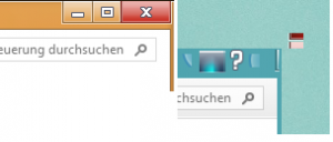

First of all thanks a lot for this wonderful programm. I am using it on 8.1 64bit with a custom theme: http://carborunda.deviantart.com/art/Snowy8-for-Windows-8-8-1-409788674
I also donated two days ago.
Today, after a restart, new symbols were downloaded by dwm.exe. Unfortunately since then, neither the standard theme nor the custom are working anymore.
See attached screenshot: Left one: Standard thema - not flat anymore, everything else ok, but I like the flat one.
Right on: Custom theme, totally weird.
How do I get the old look back?
You installed glass theme although you use your own theme. It's incompatible (I should add a notice into the installer). To change glass custom theme, read the guide on the website.

I don't understand you much. Your screenshot shows that Aero Glass works as expected, so where's the problem?
