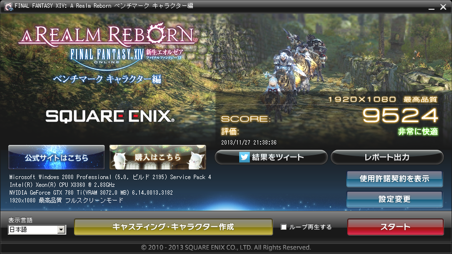

I released nVIDIA forceware 331.65 for Windows 2000 released.
it has a proble.
If you select "change resolution", the cpu usage go to 100%.
It seems fail to load resource and loop it.
