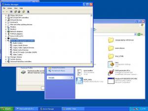

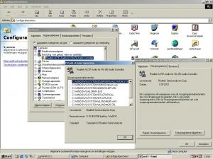

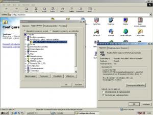

Trancelistic Posted July 29, 2012 Posted July 29, 2012 (edited) Hi all, I'm trying to give my old laptop some new life with installing windows 98 again.I do have most experience with this old OS, However I cannot get the sound to work.The install (for win98) does find it, and install properly but after a reboot it gave the following flag in the decive manager: ( I'll try my best to translate the info into English): - "The NTkern.VXD, MMDEVLDR.VXD device program(s) are unable to load the driver(s) for this device. (CODE 2)"Checking out the installed drivers, they are all there. ( well it shows a bunch, check screenshot)I've provided some screenshots, taken on win98 and on winxp ( dual boot, same system)On winxp, the sound automaticly installed, during setup, saying its a via ac97 WDM etc. So Therefor I've googled for the via ac97 for win98 and installed that on the win98 OS. It installed fine, but still no sound and a flag in device manger as said above.Any 1 knows what I'm doing wrong?A solution would be awsome.Some specs: Its a compaq evo n150 laptop, 700 hz celleron 64 mb solderd memory minus 8mb for the video ( wonder win xp ran with 56 mb of memory) . I believe with the appollo chipset and via southbrigde. I can look it up wich one with cpu-z if needed. Greetz trancelistic.EDIT for some spellings ( I hope i got all )Ps: On the official HP/COMPAQ site, onder the page for driver for my Compaq EVO n150. It has all drivers but no sound provided. Wow HP why? It doesn't even give info where to get it. Ps2 offtopic. How to make a flash drive work under win98?. Now I keep rebooting to wxp to copy /try new drivers for w98. Edited July 29, 2012 by Trancelistic

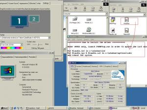

Trancelistic Posted August 1, 2012 Author Posted August 1, 2012 (edited) First of all, sorry for a double post but I tought it would be beter to show theese screenshots in a new postSo, is this w98 or w98se? How to tell, I tried to bring up as much info as possible on a 1024x786 desktop screen lol.Thanks in advanced.To reply to Loblo's post: On the screen in red ( the text, is of that install/driver that you;ve suggested. When trying to execute the install it simple says its not made for this OS.Greetz all Edited August 1, 2012 by Trancelistic
submix8c Posted August 1, 2012 Posted August 1, 2012 4.10.2222 - Windows 98 Second Edition (Win98SE)How odd! That EXE file is specifically for Windows 98 Second Edition. Do you have any "unofficial" updates installed (eg 98SE2ME) that would make it "think" that it's not 98SE? It's an Update for the USB Bus, AFAICT.@loblo - do you mean (e.g.) "A404"?Here is apparently a v4.04 (dated 2008) that include all of the OS WDM Drivers -ftp://ftp.tsu.ge/drivers/Audio/WDM_A404.exe(18mb file)BTW, the Driver you have is for a VERY specific model. The one I give is for many - I have an even older version on my current PC (A3.90)
