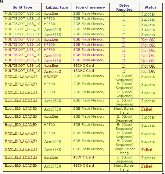

Good News :thumbup:thumbup , but not for everything.
i newly installed a fresh windows and did a new test as per the above cases with the below status:
Using BOOT_ISO_LOADED:
SDHC Memory Card Finally success on Asus but still failed on Acer5738.
Flash Memory Success on all labtops except Acer5738
So, I still have 7 scenarios Failed using "MULTI_BOOT_10" against 3 scenarios Failed using "BOOT_ISO_LOADED"
I think, it is logic trying to kill the three instead of 7
:unsure:
the last one is the important one to me......
Edited by robekia
