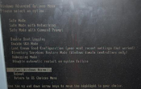

On F8 I see this pic.

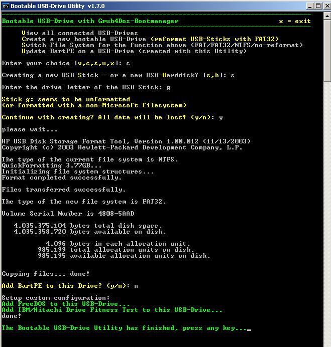

Format Stick procedure of Make_USB.exe
Will try, thanks. Will get another stick for this, I guess.
Sure :), that's the normal "safe mode" of Windows.
Whatever, the point was I am able to see 3 screens, not 2 like I said before.

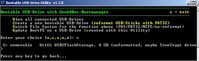

The other thing to try is to see if, since you have a USBest UT165 controller, the correspondent "manufacturer tool" can "flip the removable bit".
The tool should be this one:
http://flashboot.ru/Files-file-219.html
http://flashboot.ru/uploads/files/public/U...5_1.65.17.0.rar
The manual for it should be this one:
http://flashboot.ru/uploads/files/public/U...ual_EN_V4.0.rar
If it works, the stick becomes a "fixed" device, just like any hard disk, and thus the ASUS should recognize it properly.
