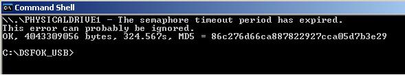

Let's go to "plan D":
As an alternative:
  1. confirm that you are using one particular stick
  2. run dsfo on that stick as detailed here:
    http://www.boot-land.net/forums/index.php?...c=5000&st=1
  3. post the exact number of bytes tranferred
And I'll create manually a valid MBR for you.
jaclaz
  • yes, it is the same stick
  • dsfo \\.\PHYSICALDRIVE1 0 0 NUL
  • 4043309056 bytes
