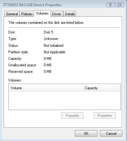

Posted (edited)
Hello Everyone,
Apparently my drive seems also bricked too. I am getting "Incorrect Function" when I try to initialize the disk via Disk manager on windows 2008.
Manufacturer : Seagate
Model : ST3500320AS
Barracuda 500 GB 7200.11
I ordered the necessary cable and going to follow the process soon,
Can you please check the screenshot, is it the reason when LBA0 happen to a disk... I beleive its not BSY because I am able to see it on windows...
Thanks,
M.G.
post-398819-0-78682600-1413817359_thumb.
Edited by maqic
