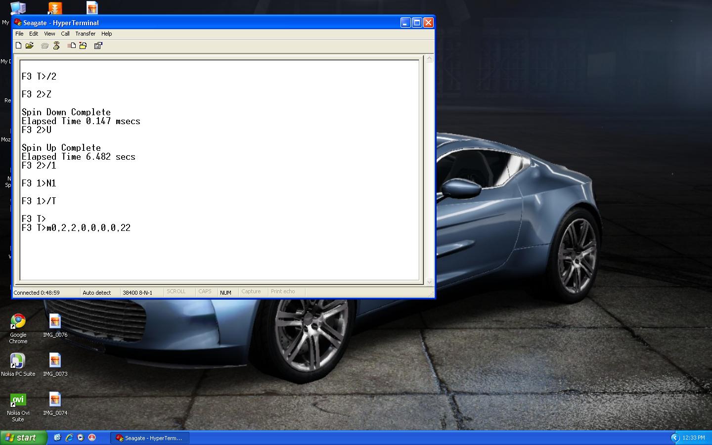

104 Posted June 5, 2011 Posted June 5, 2011 (edited) You READ the few posts before I pointed you to? and redo EVERYTHING from the beginning, this time actually READing and doing EXACTLY what the guide:http://www.mapleleafmountain.com/seagatebrick.htmlsays.(and re-checking EVERYTHING)jaclazSorry for asking the same questions over and over again.. Just wanted to confirm before doing anything..P.S. I really appreciate the time and effort you put in explaining things to people like me.EDIT : I did the whole thing again from scratch.. it when smoothly till the point where the guide said to remove the sata cable from HDD.. I removed the cable and plugged it back and now when i pressed Ctrl Z, nothin happened.. Here's the screenshot.. Thanks a ton again. Edited June 5, 2011 by 104

BlouBul Posted June 5, 2011 Posted June 5, 2011 The only advice I can give is to echo jaclaz's comments. Repeat the whole exercise again, carefully checking and re-checking all steps and connections.

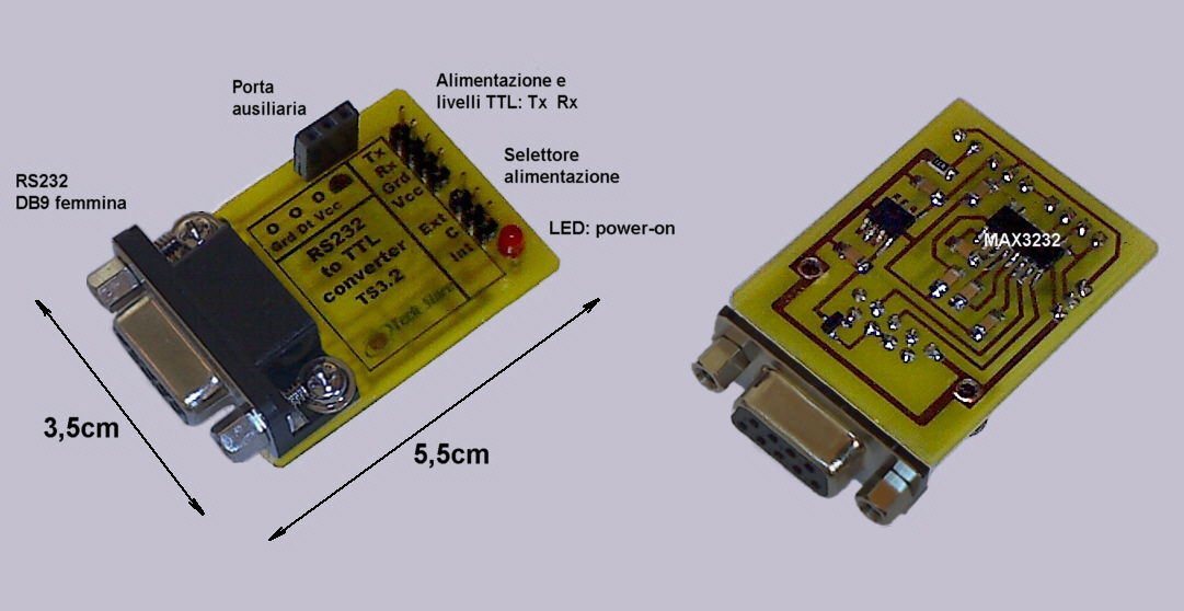

PredTek Posted June 11, 2011 Posted June 11, 2011 Hi all...I own a Maxtor Diamondmax 22 500gb SATA hd... it seems to have the BUSY problem.I followed with care the guide on the first post but when I type on Hyperterminal CTRL+Z to open the prompt, something STRANGE happens... random simbles appear, like exclamation marks, smiles (wtf?) and hearts...The HD is connected to this. The adapter is supplied by 2 AA batteries and the hard disk is feed by a sata cable... what do i wrong? Obviously the PCB of the hd is separated from the contacts... Rx and Tx cables are ok... can anyone help me? [this is an example of wtf happens when I press CTRL Z http://img148.imageshack.us/img148/3487/asdys.jpg]PS: sorry for my poor english, I'm from Italy and schools pretty sucks there.
