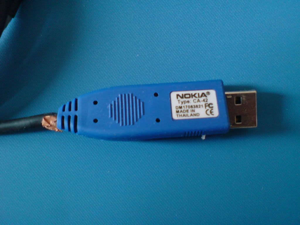

freshmen1020 Posted September 8, 2009 Posted September 8, 2009 I do have a question,I was following the thread and was wondering what I am doing wrong.I added the wire for the HDD Tx/Rx and connected them into the CA-42 Rx/Tx then connected the CA-42 USB to the pc usb slotThen went to the hyperterminal and can't seem to connect to the HDDIs there something that I missed?

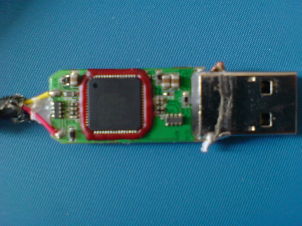

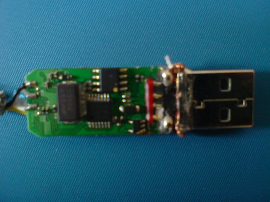

KlingKlang Posted September 10, 2009 Posted September 10, 2009 to: freshmen1020 & 03VetteI´m sure that your cable is working fine. Have you tried to connect +3v on the cable?My CA-42 was not detected in windows until i connected a 3v battery and it suddenlywas detected. The reason for it works with a nokia phone, is that the phone is poweringthe cable with +3V. I´m going to post a series of pictures so you can test if it works or not.if your inpatient, check my previous post at page ~85-86 something. /Cheers, KlingKlang

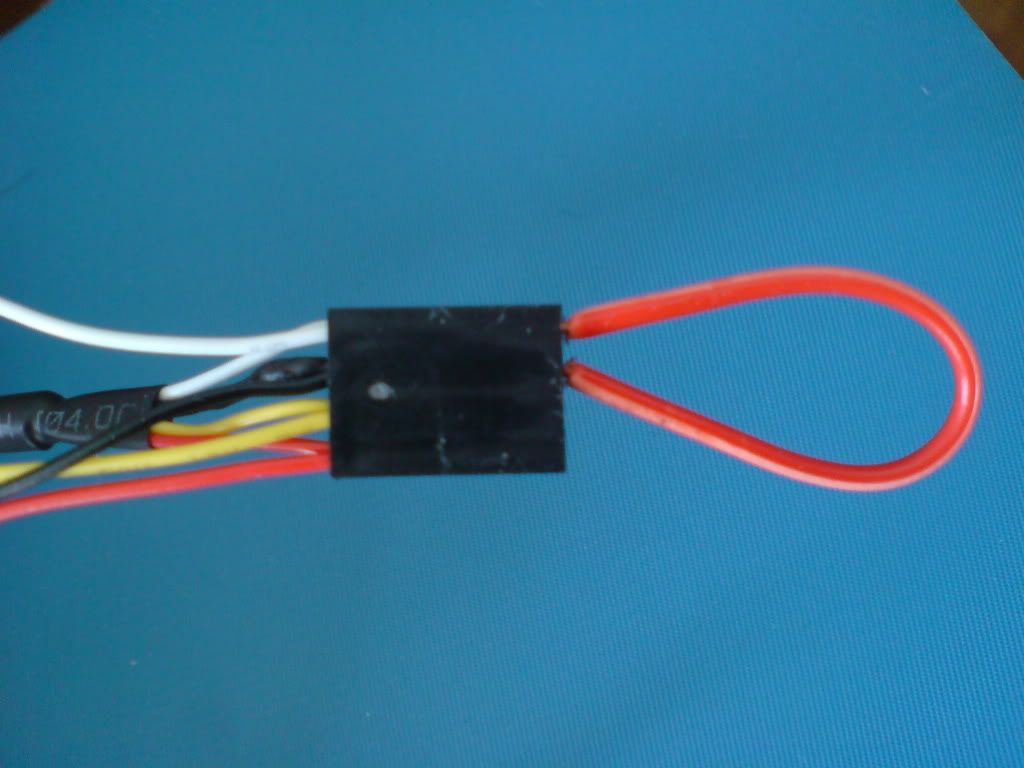

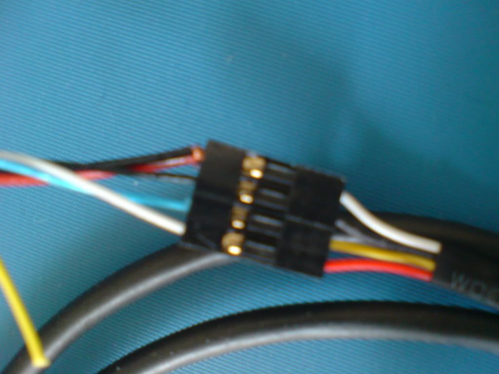

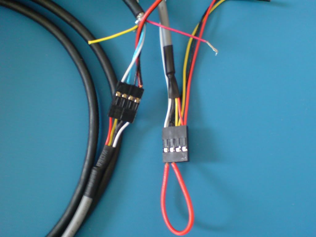

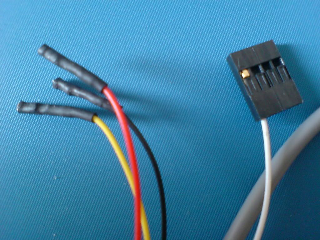

KlingKlang Posted September 10, 2009 Posted September 10, 2009 (edited) to: freshmen1020 & 03Vette and everyone else wondering about the CA-42.Correct pinout for the Genuine Nokia CA-42 is:Pin 1 = Ground (Black)Pin 2 = Tx (White)Pin 3 = Rx (Blue)Pin 4 = ??Pin 5 = +3.3v (Red)Pin 6 = ?? (Yellow)Use a multimeter to determine what color you cable has.Close-up of usb-contact.Close-up other side of usb-contact.Close-up of the circuit. The white plastic-cover has been removed.Close-up of the circuit. The white plastic-cover has been removed.Wiring close-up. Because i used a 3-connector audiocable, i jumperedthe black and white ON THE AUDIOCABLE on one connector, not the usb-cable.I then used the second to the hdd-connectors and the third to connect to the usb-cable.The important are that you connect +3V to the red usb-cable and black usb-cable.Wiring close-up. More wiring pictures... The red-black is connected to the white-audio cable and should beconnected to the Gnd on the battery, while the red usb-cable should be connected to +3.3V.The computer SHOULD detect "Nokia Parent Phone Modem" when you powerup the usbcable with a battery.Dont forget to install the drivers!white, blue and black is from the usb-cable, red, yellow and black are audiocable.Hdd-connectors... Here i removed the connectors to the audiocable and put a tiny heat shrink hosearound to prevent from short circuit. Use a very tiny hose or it might be to clumsy. It isalso a good idea to use a needle to poke on the connectors so the can grab the small pins on the hdd.Follow the rest of Gradius2´s guide for the rest.See post #1583 for further details!Well, it looks like a rat´s nest, but it worked for me. email me: henric_tomasson[at]hotmail.com if you have more questions Edited September 10, 2009 by KlingKlang

KlingKlang Posted September 10, 2009 Posted September 10, 2009 This is the correct method.Place the paper/card between the "head contact" and the PCB.Remove it AFTER spindown is completed as Gradius2 describes on page 1."Now the tricky part. Pratice a lot without any power before even trying this. You need to make sure that the screws don't touch the PCB board where they aren't suppose to or you will fry your PCB board. If you have been practicing and the power is not connected, start at STEP ONE.With the POWER CONNECTED to the PCB board, as well as your TX/RX terminal wires, mount the board back on the HDA case. You must have the power connected when you do this."This is when you should remove the paper. You could place a paper on the "motor contact"if you want to but there is really no point doing so. It would only shorten the spindown time (i think).And that is already short enough./KlingKlang
