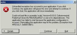

You cannot select a XP Source over a network (i see that your XP Disk is on Y:\My2K3CD)...
Ok, thanks. I didn't try that. Except I've always done it from the mapped Y: drive, so maybe something changed in 1.4RC (??)

Framework issue.
Have the same error as jimmany in Post 51 on the second picture.
XP SP2 English (x86).
First installed nlruntimer3.exe, then nLite-1.4.rc.exe (SFX version).
Was good with the same nlruntimer3.exe and nLite-1.4.beta.exe (SFX version).
Shall try restore backup image and test again.

  • Author
jimanny, did you figure it out why that happens?
Try to uninstall all frameworks, reboot then install just 2.0 full. It must work.
nuhi, thank you. I got it to work, but only with the full 2.0 x64 .Net. Before when I *thought* I had 2.0 full installed, I probably didn't cause I used ryanvm's all-in-one .Net installer (dotnetaio.exe) which probably didn't install in this XP x64 machine (I didn't check it :blushing: ). Still though, Framework Lite R3 worked fine on this x64 machine all the way up to 1.4b, so maybe something changed in 1.4RC? Or maybe I was lucky and Framework Lite R3 isn't supposed to work on x64. Either way, I'm stoked that it's working again. :)

Problem with RC2 & FrameworkLite 2.0 R3.
This error happens everytime when after nLite starts to read the Windows installation files:
Here's the details:
See the end of this message for details on invoking
just-in-time (JIT) debugging instead of this dialog box.
************** Exception Text **************
System.IO.FileLoadException: Could not load file or assembly 'ncab, Version=0.0.0.0, Culture=neutral, PublicKeyToken=5c790c52ffa26522' or one of its dependencies. This application has failed to start because the application configuration is incorrect. Reinstalling the application may fix this problem. (Exception from HRESULT: 0x800736B1)
File name: 'ncab, Version=0.0.0.0, Culture=neutral, PublicKeyToken=5c790c52ffa26522' ---> System.Runtime.InteropServices.COMException (0x800736B1): This application has failed to start because the application configuration is incorrect. Reinstalling the application may fix this problem. (Exception from HRESULT: 0x800736B1)

korri, I ran into the same error. Try nuhi's suggestion to me in post 65. 1.4.RC2 works for me, except with dotnet 2.0 full instead of lite. Also, in case you're on x64, make sure you install dotnet 2.0 full x64 so that you don't repeat my mistake! :whistle:
Still the same error as before (last time mentioned by korri a couple of posts above.
Previous version nLite-1.4.beta.exe + nlruntimer3.exe worked.
Installation on a "clean" system (just restored from backup image).
Have not tried full Framework install.
Windows XP SP2 x86 English.
