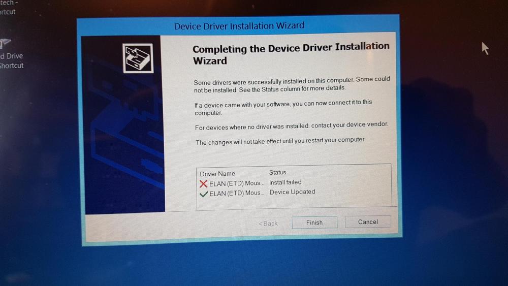

  12. OK, I installed the driver with the new INF. It seems to work fine, now with the Asus-style icon in the system tray as expected. There is no access to any settings now though through the Windows UI. The "tap to click" function can now be switched off and on with your registry files, the fly in the ointment being that you have to reboot for the behaviour to actually change!

  14. OK, here's the current version of the INF. ETD.inf
  15. At the moment, your INF doesn't add ETDAniConf.exe to the Elantech folder. Perhaps it needs to be modified to include it. Incidentally, the machine hanging for about 90 seconds on "loading your personal settings" was no better when the driver was uninstalled, so is nothing to do with this!
