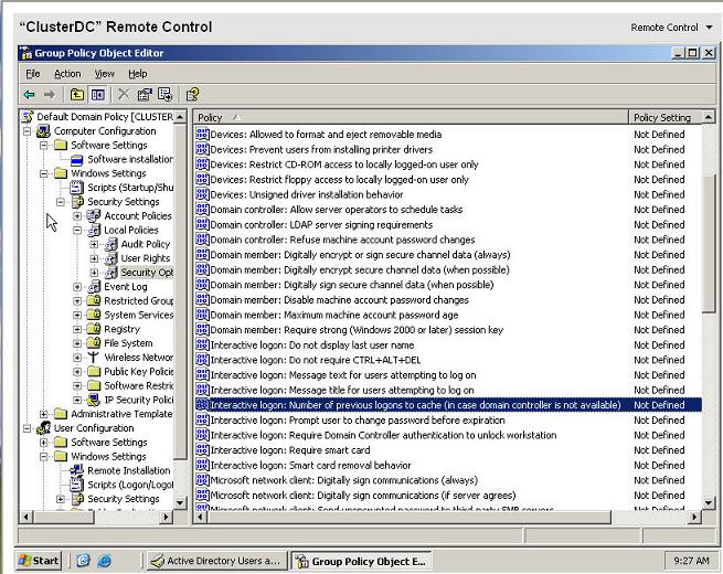

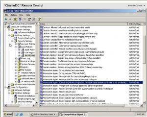

unfortuantly you will have to remove the computer and readd it to the domain, no way around that, does the client have the ability to VPN in then you can unjoin the computer from the domain and rejoin it. 1. logon as an admin remove from the domain 2 logon as an admin after reboot and VPN to domain, rejoin the domain. 3. hopefully the users account is cached on the computer and you can have the users logon with there account on the computer now and vpn in, shoudl work fine now.

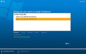

there is no F6 prompt for drivers anymore when you load up the PE, it should find the SATA driver weither it be in IDE mode or SATA mode, during the installaion, i know this is an older pic from an older build but same idea, there is a driver button here where you can load the required drivers if you Sata card hasn't been picked up yet, also have there been any Bios releases for this MB? Intel MB BIOS updates try those also see if they help at all you have to do the first one then the second one
