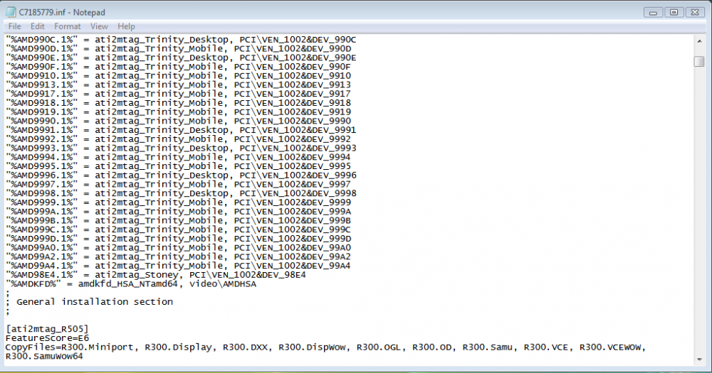

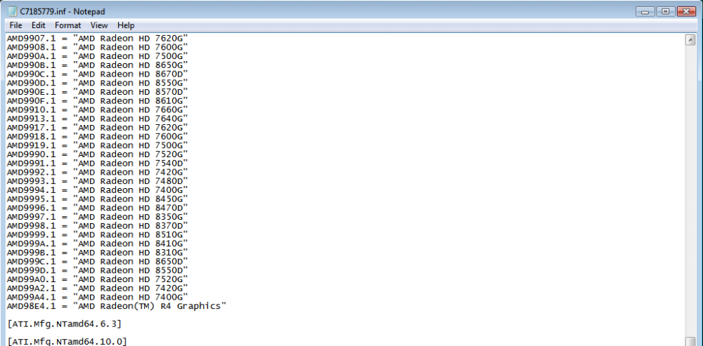

  4. I tested this with a Windows 7 laptop that I had and it worked successfully. Only problem is that it installed Windows 7 Home Basic despite it being an Ultimate ISO that was used. Also, there is a part mentioning a cert1 and cert2 file. If your graphics driver features your processor in it already (I.E. You did not have to edit the inf file), then you do not need the cert1 and cert2 files. You can just skip injecting those and inject your graphics driver. If you do have to modify the inf, than those will be needed.

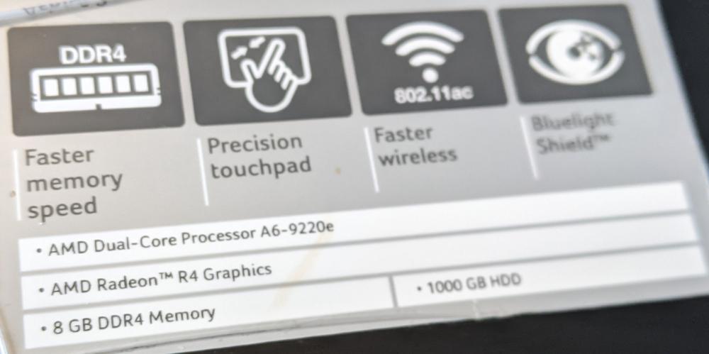

  8. It is! The pictures below show my specs. I will do so. I have a laptop from 2013 that has UEFI boot (and secure boot too I believe), but shipped with Windows 7 (UEFI was disabled though) Interesting. This laptop does support both (how I got it working in the first place). You have a guide or know of one for how to modify the bootloader? Also, if it doesn't work with UEFI, why does Rufus select it automatically when I prepare it.

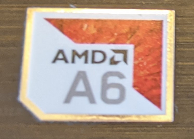

  9. Hi! I created a Windows 7 installation media in UEFI mode using Rufus with the intent to install it on an Acer Aspire A315-21 from 2019, but when I booted up the disk, it did the "Starting Windows" animation, but then froze after the Windows logo was formed. This media did not have USB 3.0 drivers slipstreamed as this laptop also came with USB 2.0 ports in addition to 3.0 (and those 2.0 ports do work with 7's setup). The hardware is AMD Radeon R4 Graphics, AMD A6 Processor(?) and AMD USB 2.0 and 3.0,, all of which supports Windows 7. In the BIOS, I disabled Secure Boot (by setting a supervisor password from the BIOS. UEFI was still enabled obviously), but left everything else except for supervisor password untouched. Does anyone have a fix for this freezing problem? I can boot from the USB using the 2.0 ports without any need for 3.0 drivers from what I can tell, but it freezes after the "Starting Windows" animation plays and the Windows logo is complete and shown. Any help is greatly appreciated here! Solved: I solved the problem using the guide from this thread: This guide was not made by me, but rather bloodhandsv over at Notebook Review. I am just sharing it for other people who may not have known this existed.
