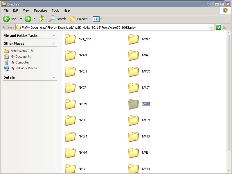

just used the new one on the forceware 71.50 from leadtek and it kept creating loads and loads of subdirectories

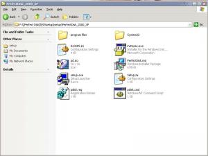

Yup i made a config.txt, Config.txt ;!@Install@!UTF-8! RunProgram="pdisk.cmd" ;!@InstallEnd@! Pdisk.cmd REGEDIT /S Pdisk.reg msiexec /i Perfectdisk.msi /q ALLUSERS=1 ADDLOCAL="PDEngine,HelpFiles,GUI,DesktopIcon" INSTALL_DESKTOP_ICON=1 Installs fine by launching the .cmd file, but when in the 7zip its a no go, hangon, you said i have to launch the .Exe? That wont be a problem aslong as launching the exe will follow the command lines if i put them in the setup.ini. Right? Tested, yup putting them in the .INI Cmdlin= works perfect when launching the .EXE Thanks 1chaoticadult, thanks alot m8
Ok dont need Autoit anymore, found the solution. When I extract the PD5setup.exe thier is a dat file, which contains some registry settings. I changed this .dat file to a .reg file and merged it into the registry before launching the MSI as i did above. Installed fine with no problems . Now this isnt tested on a unattended machine, will do so in a second. All I want to know are 3 things: Do I need all the other files in the directory with the msi? Why do other msi installs on MSFN not use the msiexec i\ command, but call them like normal .exe with the switches following I tried making this into a 7zip archieve but it doesnt do nothing when i run it, i used the same method in the nero post bellow but with no .sfx is the no sfx making the thing not work? How do i make one if so - ive tried searching thanks, plsss help me with this ive nearly finished my unattended CD then

Ok, I know 6 is mentioned in the app switches sticky at the top, but im sure I have tried to install this version using the same switches. I tought I had cracked it, in this thread: http://www.msfn.org/board/index.php?showto...35620&hl=syntax Using the code provided by Nologic: REG ADD %KEY%\050 /V 2 /D "msiexec /i %systemdrive%\install\Applications\perfectdisk\Perfectdisk.msi /q ALLUSERS=1 ADDLOCAL=\"PDEngine,HelpFiles,GUI,DesktopIcon\" INSTALL_DESKTOP_ICON=1" /f but it refused to install. The info obtained to get the discussion in the thread linked to was a readme from the extracted installer. Any ideas, ive virtually got all my apps installed now except this, MS antispyware which I now how to, steam, Nero and cuteFTP. I was going to purchase the upgrade to the latest version but Ive got be carefull on what I spend as my ISP has apparently been paid but hasnt shown on my bank statement, so i dont know how much money I have left in reality

Brilliant, Thanks alot mate, got my nvidea drivers down from 57mb, to 17 , and gotta delete one of them graphic drivers ones still. Now down to 11.7mb atfter deleteing the nv_dsp2 folder. , good luck with your programing.
Do you mean compressed or decompressed? After using your batch on nVidiadrivers, three directories were created: 1. A maindirectory called Display 2. Two subdirectories in Display called nv4_disp and nv4disp2 Which directory do I need for my Unattended Disc? They both have almost the same files but nv4_disp is a little bigger (about 0.02mb). BTW, I have a Geforce4 TI4200 8x AGP EDIT: What is installed by nVidia-installer that isn't installed by windows-setup.inf-method? Hi, I would like the same answer to this question, with Nvidea graphics drivers i get 2 sub directories, which do I use? Also, do I just use the files created how I usualy would? i.e: put them into folders in the $OEM$\$1\drivers\device folders and then point to them in the PnPdriverspath in Winnt.sif? If so then this tool is brilliant, so handy for reducing bloated nvidea drivers. Many thanks
