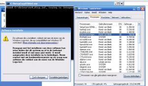

****, that is nasty. In that case you have to click a zillion times I don't think that this is the problem. My SetupCopyOEMInf.exe was once running next to WPI, which launched a RunOnceEx kind of screen. All went fine. I don't use RVM's update pack myself, but a lot of people have/had problems with his pack combined with Bashrat's pack. I wonder if the problem is solved without RVM's pack? -

I don't have this problem. For me it works perfect. Then again, I only use Bashrat's packs, and other WHQL drivers. edmoncu, do you get this pop-up when you install non-WHQL drivers, or do you get it all the time (even without non-WHQL drivers)? EDIT: I did some testing with non-WHQL drivers. First I tried non-WHQL drivers for my wireless card. When I use WatchDriverSigningPolicy.exe, they install (slipstream) fine. The next test was with the latest Nvidia (video) Beta driver. When I use WatchDriverSigningPolicy.exe this time, it didn't work. Compare the above with this: When I tell windows not to whine about the driver signing (turn it to ignore) my Wireless drivers install fine. My Nvidia drivers however, still give me the pop-up It seems that for some drivers (or devices) the drivers signing can't be ignored -
