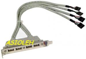

  3. The Benicia is an Asus board. This means that the headers probably are active, and no daughterboard is needed. But the type of the headers is unusual... you'll need four individual four pin (or five pin) connectors for the headers, not two double-row (four or) five pin connectors, which are the most common type. See the attached picture for an example.
