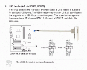

@PuntoMX: the four connector backplate you linked to has two ten-pin header connectors, so it won't do. The right type exists, as you can see in the pic I posted many posts ago (here), but it's really hard to find anyone selling that.
While I agree with jaclaz, I think that since JorgeA has acquired a multimeter, it'd be good for him to learn how to use it properly. In any case, the common test leads that come with the average multimeter are too thick for performing good measurements on motherboard headers or the tracks inside a female type-A USB connector. To overcome this I extend the red lead with a sharper thin object, which I fasten snugly to the lead point with common adhesive tape, taking care that no tape gets in-between them, so that there's good electrical contact between the extender object and the lead point. A common sewing needle, a shirtmaker's pin with the head cut off, or even a hypodermic needle with the female Luer-Lok cut off are good choices for the extender object. The pic below depicts my own red test lead extended with a shirtmaker's pin with the head cut off. Of course, just after fastening the pin to the test lead, the sanity checks #2 and 3 from my previous post must be repeated, but this time using the pin's point, just to be secure there really is good electrical contact betwwen the pin and the test-lead's point. There is no need to do it to the black test lead too, because that will usually be grounded by inserting into one of the center holes (any of the two which are connected to black cables) of an unused molex connector, and for that the test lead has just the right thickness.

So, you don't want any "low-profile" backplates, but normal ones (they usually don't say they're "normal", but when they are "low-profile" that is mentioned). Yes, we must locate the +5V pin, by using the multimeter, since all the documentation we gathered before didn't provide actual pinouts (the description of which pin is which) for the headers you're going to use (more on how to actually do it later, in my next post). However ASUS is consistent, and their manual for my my boars does provide a pinout for its headers. Since you board has both double-row (2, white and black, used) and single-row (4, black, unused) USB header, I bet all of them have the same pinout, with the +5V pin being the leftmost pin (the one nearest the back of the motherboard) and the ground pin being the fouth pin, which, if the 5th pin is missing (and it should be), is then the rightmost pin, the one nearest to the fron of the board, after which there is the empty space for the missing 5th pin, in each header. So, if we confirm this by using the multimeter, we're safe to go on.
In any case, 4-port backplates put the USB ports too close together for my liking (it makes it difficult to use, say, 4 pendrives at the same time). I'd either use two backplates with two USB ports apiece, or one backplate and one front bay plate, preferably a 3.5" one, if there are any unused drive bays available in front.

You've hit jackpot! The five pin black connector to the motherboard headers is the correct one in both. The difference is the height of the back-plate. A normal one is about 4.75", while a "low profile" is about 3.14". The only way of knowing for sure which you should buy is by getting a ruler and measuring the height of any of the back-plates already present in your machine (the video card is the most obvious one to measure, and if you use a thin flexible plastic (not metal!) ruler, you can measure it precisely enough from the back of the unopened machine, or from the inside, but in any case, don't need to remove the card to measure). Since you want to distinguish 4.75" from 3.14", there's no need for great precison, after all.
