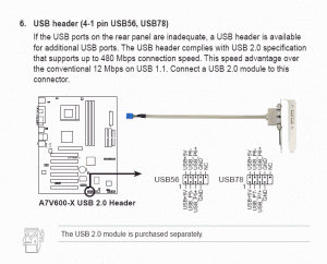

jaclaz is right (of course!): pin 9 is "KEY", being usually not connected (viz. "NC"), or, less commonly, grounded. Now, pin 10 is absent (= missing), so that one can immediately recognize which pin is pin 9 (because it's the only one that has no conterpart). Reversing "Data +" and "Data -" causes the port not to work, but usually causes no damage, so it can be corrected (this seems to me to be the problem with your machine). Now, reversing "Power +5V" and "Ground" can kill the motherboard, so take care with what you do, and don't do anything unless you're sure of what you're doing!
