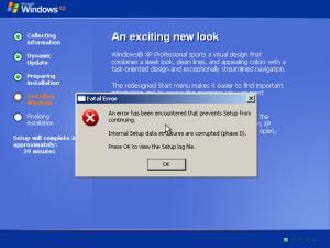

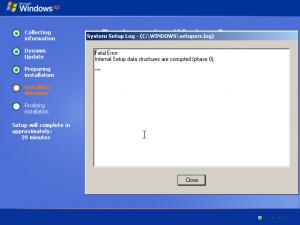

    Fatal Error
    Never mind.... Alanoll saves the day once again... the first two lines were the culprit...
  11. Wraith
    Fatal Error
    Soooo... I get the error in the attached images... Any ideas? I know it's XPCREATE, because the XPSP2 source I'm using works fine normally. Been a while since I've used XPCREATE... what files should I be posting? (Error typed out for search purposes if other people get it at some point along the line... the attachments may not always be there,,,) Fatal Error An error has been encountered that prevents Setup from continuing. Internal Setup data structures are corrupted (phase 0). Press OK to view the Setup log file.
