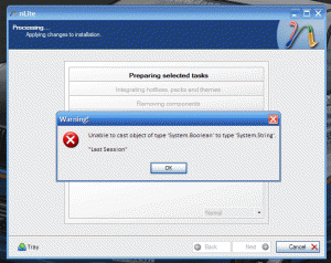

jcarle Posted October 30, 2006 Posted October 30, 2006 (edited) Also, it could be related to the fact that I had checked the "Include LastSession.ini on CD" option.Nope, did it again. I have no idea why.exceptionText.txt Edited October 30, 2006 by jcarle

jcarle Posted October 30, 2006 Author Posted October 30, 2006 Found the reason for the crash!nuhi, if you read this!On the options page, the "Clean MUI Languages support entries", "Black background" and "Classic" options are marked as "No" originally, but when you modify the options, the choices are True/False. Somewhere, something goes wrong and the cast to a boolean is failing from that.You could try using something like: string optionVal = string.ToUpper().Replace("ENABLED", "TRUE").Replace("DISABLED", "FALSE").Replace("YES", "TRUE").Replace("NO", "FALSE");if (optionVal.Length == 0) optionVal = "FALSE";bool optionResult = Convert.ToBoolean(optionVal);

nuhi Posted October 30, 2006 Posted October 30, 2006 Only problem when I change the value it's yes/no, never true/false...edit: **** when i try the installed version it's true! Gonna rebuild it, it may be some compiling mistakeedit2: 1.2.1 available
