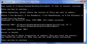

hi guys, i need a bit of help
i have followed the instructions down to Integrate.cmd when i run this and get to the part where it is trying to mount install.wim, it fails because it says access is denied, i have tried to take ownership of the install.wim, and the containing folder useing "takeown" in cmd and from the properties window for both again, and i cant seem to get access, the file and the folder both claim to be in my ownership, but it will not work.
Thanks.
Are you running your scripts in Elevated Privileges mode?
I think that error occurs because of that - Vista will not mount images unless you run in elevated mode. It really sucks.
I was thinking that i was running them in elevated mode, im telling the scripts to run as administrator, by right clicking on them. and again i just get the same problem.
Im not too sure about using that "VISTA32 hotfix-TOOL" because im running the 64bit version (sorry if thats got nothing to do with it, im assuming because it says vista32 that its 32bit)

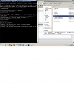

Getting error message when running integrate.cmd. Can anyone tell me why...?
Thanks!
The error I see is that it can't find PEIMG.exe. If you read the first post there is this:
The only place peimg.exe is used in this guide is to create a text file that lists the packages that were integrated.
By that description, it may not be a critical error, but I have not used this program before.
