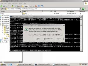

Seems to work pretty well, no more errors due to Windows Server 2003 \Device\PhysicalMemory permissions
On a fresh Windows Server 2003 R2 Standard installation "Windows File Protection" kicks in once when runing oemscan for the first time (just after replacing COA oemfiles with vendor specific server 2003 oembios files)
When clicking "Cancel" and keeping the new files after reboot all seems to be ok.
I could even run SFC /Scannow without the original files being restored, so that looks good as well
UPDATE: When running oemscan on a fresh install of Windows Server 2003 Enterprise Edition with SP1 i didn't get the "Windows File Protection" dialog...(maybe something went bad the first time)

I was worried the method I use to disable SFC in XP wouldn’t work in W2K3 however when I tested it with W2K3 R2 Standard Edition Service Pack 2 (Volume) it passed with flying colors. The method I use disables SFC for exactly 1 minute on specific files. Is it possible more then 1 minute elapsed between copying over the files and importing the .CAT file?
Could you test it on more systems and get back to me if you run into SFC errors? Perhaps I should import the .CAT file first.
