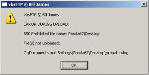

heres what i have
[\CODE]
' * * * * * * * * * * * * * * User Variables * * * * * * * * * * * * * *
' FTP address for the root of your web site:
' Example: "ftp.myISP.com" (check ISP help page for details) *
FTPaddr = "00000000"
' Local folder that equates to the root of your web site: *
BaseDir = "C:/Documents and Settings/Panda67/Desktop/"
' FTP username for your site: *
UserName = "00000000"
' FTP password for your site: *
Password = "000000000"
' ---ADVANCED Setup Options--- *
' (If you don't know what ascii upload means, leave this alone!)
' Files to be uploaded in ASCII format: *
arASCII = Array("rar","bmp","jpg","log","txt", "cgi", "pl", "htm", "html", "asp", "js", "vbs")
' Suppress Popup if upload succeeded (True or False, no quotes): *
ShowSuccess = False
[\/CODE]
And now im getting it must be in that DIR or a sub dir ;/
Edited by Panda67
