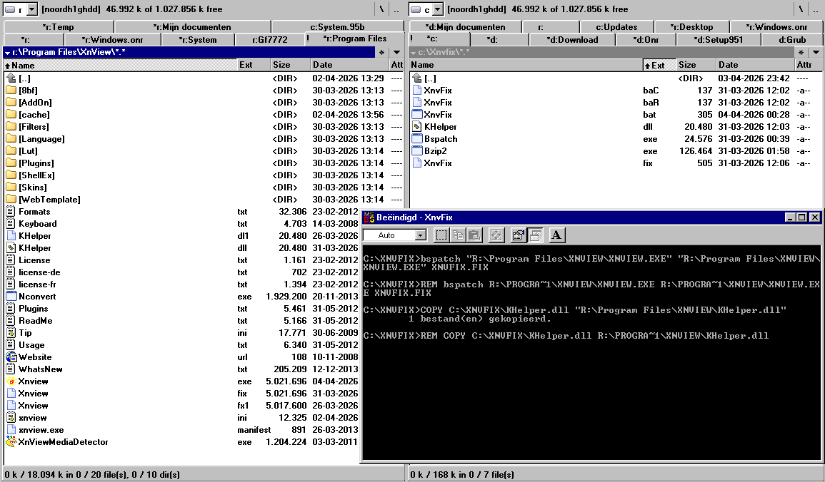

Here's the second fix for xnview  https://filebin.net/i4dvch4eyiktta2d, once you apply it you won't need SH95UPD, but it must be freshly installed xnview
extract the package to C:\ and run the XnvFix.bat.

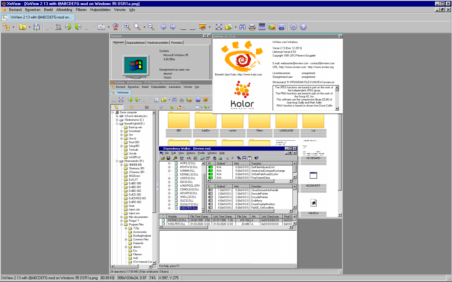

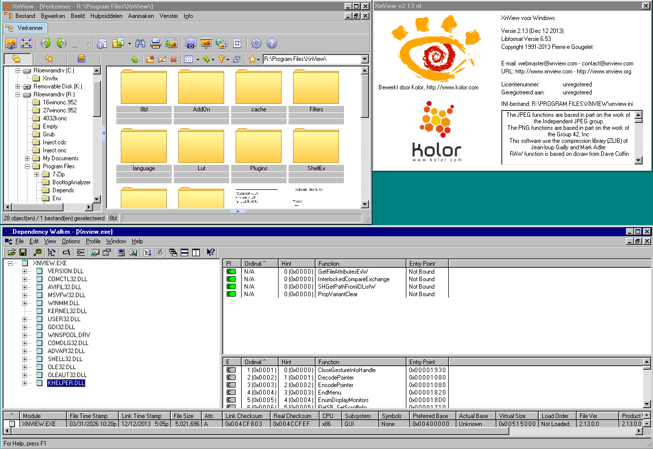

@ABCDEFG before running the fix I only had to adapt XNVFIX.BAT to my Program Files drive-letter. XnView v2.13 seems to run out of the box on a clean system, without SH95UPD:
XNVFIXstartedxnview2.13DependencyWalker.thumb.png.b4b89aab146c1c874ed8010f40e2239a.png
@cov3rt about posting images: above image is a slightly cut 1920x1200 print-screen, pasted into Irfanview and saved as *.png and then drag-and-drop into the post. This one has filesize of 78KB, even less is possible with png. :cool:

First I just copied the fix from Windows 95 OSR2, but today I tried a fresh one in Windows 95a. Everything is fine, I only had some initial issues not founding the XnView directory, but that was an easy job compared to yours. :worship:
