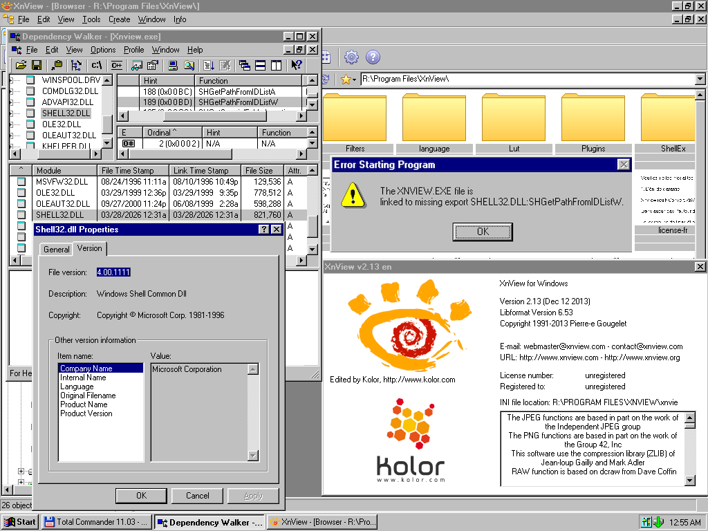

Hi @ABCDEFG very nice job!
Although it took me a long time to surpass next missing export (no IE4 on my system, and installation on my non-XMS Ramdrive gave problems).
But in the end I succeeded with help of SH95UPD, version 007:
SH95UPD.007withSHELL32.DLLexportstartedxnview2.13DependencyWalkerSHELL32versionoriginalError.thumb.png.f6d434a9c9cc3ef087bac01af65437d1.png
Maybe im misunderstanding from the screenshot, but is that shell32.dll 4.00.1111 the version your windows 95 pc was using at the time, because isn't latest official version 4.72.3612.1700 for windows 95?
Sure, I was not able to install latest version of SHELL32 DLL, coming with IE 4.01 (if I am right about 4.01), because of installation issues of IE4 on my non-XMS ramdrive. But in print-screen in post of @ABCDEFG you can see he should have a later version.
Simply copying that version of SHELL32.DLL to %winbootdir%\SYSTEM as a workaround is not possible, Windows is not starting anymore in that case.

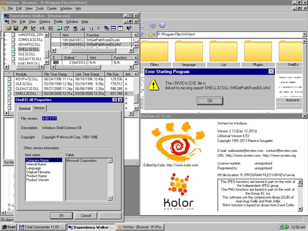

In the print-screen I copied in the missing dependency BEFORE if got things working with SH95UPD (you should be aware of SH95UPD, because of your contributions in that thread on MSFN, although years ago).
So xnview 2.13 is running on my system with patched SHELL32.DLL v.4.00.1111. As you can see in the Dependency Walker part of the print-screen, the earlier missing export is added to my version of SHELL32.DLL.
Missing export was originally only showed AFTER using the xnview v2.13 mod of @ABCDEFG , but not anymore with patched SHELL32.DLL.

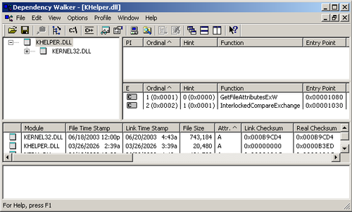

@ABCDEFG I looked into the dependencies of WEBP.DLL in Plugin-directory of xnview v2.13, I found two missing in my version of KERNEL32.DLL:
@deomsh I'm sure there are many more missing functions because i've tested on other systems as well and it doesn't work on Win98, and it doesn't work on WinMe either.
But it works on Win2k.
We may need a different approach to this problem.

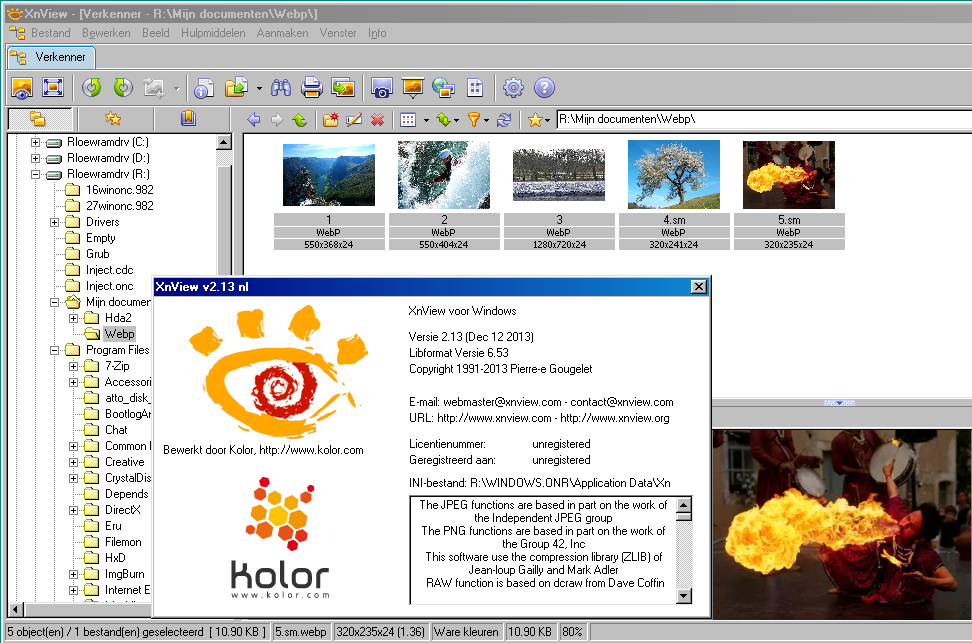

However with KernelEx 4.5.2, I installed temporarily on my non-XMS Ramdrive-Windows 98SE installation, original XnView v2.13 with WebP is working 'out of the box':
So maybe you can continue with SH95UPD? :rolleyes:
During searching for this tool, I found out SH95UPD is based on an older version of KernelEx: v0.3.2a. I am not sure if I ever used SH95UPD before. :unsure:
i did not paste screenshot as the forum only allows a certain file size, i dont know how to workaround this, that's why i mentioned it in my earlier post, but i also edited that older post so the link should include the file for a few days at least. as for the other responses, we are getting some good progress here, it shows that even on 98SE, one needs kernelex 4.5.2 for xnview 2.13 to work correctly, at least for webp in testing, for windows 95, shows 2 missing depedencies in your screenshot.
even when those two missing functions are replaced the webp.dll after loading tries to call some other functions, those functions do not exist in 9x Kernel32.dll, one of potential solutions would be to replace the GetProcAaddress function and when it tries to call some of those non-existent functions, the call is redirected to another dll that provides the necessary functions.
