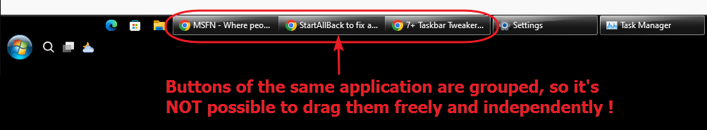

George2005 Posted September 12, 2024 Posted September 12, 2024 Well, if I understand @sazkion correctly he means that he isn't able to rearrange the different instances of the same application by moving the appropriate taskbar buttons or if he rearranges the different instances of the same application by dragging the thumbnail the appropriate taskbar button position doesn't follow the thumbnail position instantly. Well I'm also very sad that 7+ Taskbar Tweaker is no longer working with SAB. For many many years I've used it to disable the grouping of the taskbar buttons of the same application so it allows me to drag the taskbar buttons freely and independently regardless the original group (e.g. multiple instances of Google Chrome) - please see picture (it's SAB 3.7.11 & 7+TT 5.15.2): But now with SAB 3.8.+ it's no longer possible: So I would like to ask, if it could be possible to implement ungrouping the Taskbar buttons of the same application's instances in SAB, and eg. add it as a new item in "Combine taskbar buttons" list box in "Tweak behavior and superpowers" section at Taskbar pane of SAB (such item could be labeled something like "Never and don't group" etc.).. Thank you very much.

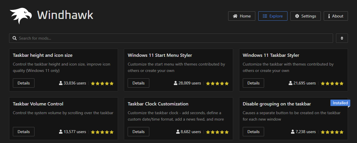

ninjakivi2 Posted September 22, 2024 Posted September 22, 2024 +1 for this feature. Recently I have updated Start is back, and it looks like the latest version is incompatible with 7+ taskbar tweaker, so I'm looking for a way to revert to older version so I can ungroup icons on my taskbar again. I also installed Windhawk, but it seems incompatible with start all back as well. Note that the feature to ungroup taskbar icons is the 6th most popular mod on that platform: To expand as to why this feature is needed: It's quite simple. Let's say I'm working on something, and have 7 tabs open. Now, I get a call that someone needs something from me, and I need to open explorer to fetch and image and paint to maybe change image format. When I open said program windows, I want to ensure they open to the right of all my task list, so I can quickly recognize where they are, to quickly close them afterwards, and be able to navigate between them. I cannot do that if I already had explorer or paint opened before; these tasks would open in arbitrary places on my taskbar and I don't like that. I have been using 7+taskbar tweaker for about 10 years now as it provided me with necessary features, but now that it's incompatible with start is back I'm quite upset. The perfect solution would be if start all back provided me with that one single feature that is missing so I don't have to rely on more tools to do the job.
