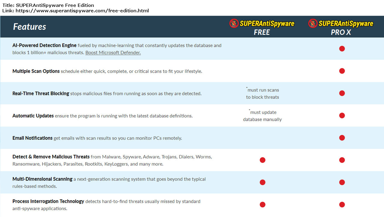

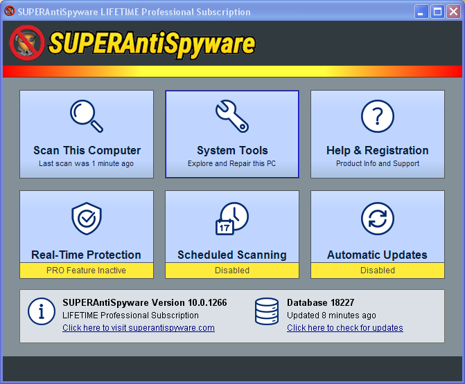

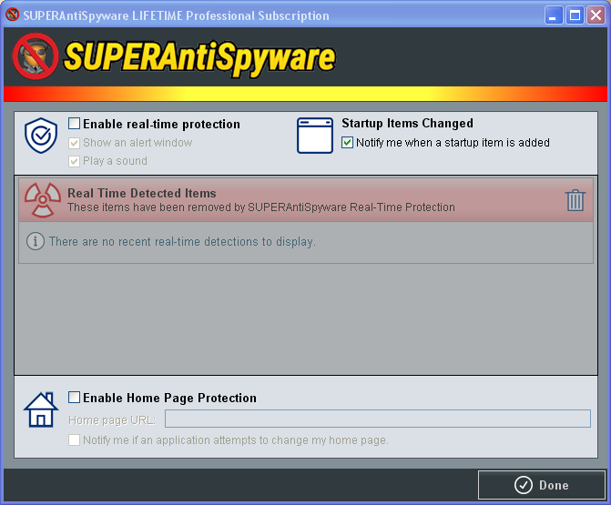

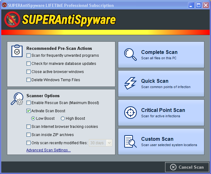

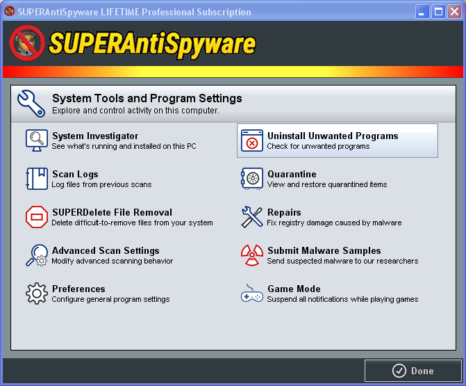

AstroSkipper Posted July 7, 2024 Author Posted July 7, 2024 (edited) SUPERAntiSpyware Free and Professional X Edition SuperAntiSpyware analyses Windows systems for malware of all kinds. Both versions, the Free Edition and the Professional X Edition scan the PC for spyware, adware, malware, Trojans, dialers, worms, keyloggers, rootkits and hijackers. According to the developers, the software with an AI-Powered Detection Engine recognizes more than 1 billion malware threats. Unfortunately, real-time protection is only available in the commercial Professional X Edirion. Although it is not listed on the homepage, SUPERAntiSpyware is compatible with Windows XP (and probably with Windows Vista too). Only the more recent installers are no longer compatible with Windows XP, starting with the version 10.0.1256. The definitions database can also be updated offline. Comparison of features: Homepage: https://www.superantispyware.com/ More details about the features of each version can be found on their homepages. Homepage of the Free Edition: https://www.superantispyware.com/free-edition.html Homepage of the Professional X Edition: https://www.superantispyware.com/professional-x-edition.html Version number: 10.0.1266 Date of release: 29.04.2024 System requirements: Windows XP, Windows Vista, Windows 7, Windows 8, Windows 8.1, Windows 10, Windows 11 Version history: https://www.superantispyware.com/producthistory.html?id=SUPERANTISPYWARE Articles, tests and tutorials: https://www.computerbild.de/artikel/cb-Tipps-Software-SuperAntiSpyware-Changelog-Tutorial-und-SuperAntiSpyware-vs.-Malwarebytes-33203535.html https://www.computerbild.de/download/SuperAntiSpyware-Free-Edition-4219359.html (German websites, please use an online translator!) https://www.clevguard.com/spyware-remover/superantispyware-review/ https://www.softpedia.com/get/Internet/Popup-Ad-Spyware-Blockers/SUPERAntiSpyware.shtml Download links: Free Edition (last installer compatible with Windows XP): https://download.filepuma.com/files/spyware-removers/superantispyware/SuperAntiSpyware_v10.0.1254.exe Free Edition (latest installer only compatible with Windows 7 and above): https://secure.superantispyware.com/SUPERAntiSpyware.exe Professional X Edition (last installer compatible with Windows XP): https://download.filepuma.com/files/spyware-removers/superantispyware/SuperAntiSpyware_v10.0.1254.exe Professional X Edition (latest installer only compatible with Windows 7 and above): https://secure.superantispyware.com/SUPERAntiSpywarePro.exe Definitions Database Updater: https://secure.superantispyware.com/SASDEFINITIONS.EXE Definitions Database Information: https://www.superantispyware.com/definitions.html Installation instructions: After installing the version 10.0.1254, you simply have to execute the internal updater to get the most recent version installed. Here is a screenshot of the Free Edition after executing the internal updater under Windows XP: The installer of the Free Edition can also be used to install the Professional X Edition if the user owns a genuine licence code. Screenshots: I have been using SUPERAntiSpyware since 2007, starting with version 3. The last compatible version with Windows 98 and ME was 4.24.1004. Since 2011, I have been in possession of a lifetime licence and have been using it in the Professional Edition ever since. SUPERAntiSpyware Professional has been XP-compatible for many years and actually runs without problems. Only a short period the XP compatibility was broken when it came to the version 10.0.1252 but then immediately restored again. However, the more recent installers are unfortunately no longer compatible with Windows XP, starting with the version 10.0.1256. This means that the actual SUPERAntiSpyware programme runs perfectly under Windows XP , but unfortunately the current programme installers do not. Besides the scanning features, the tab System Tools is very interesting and helpful for repairing PC damages caused by malware. The Free Edition is definitely worth a look and simply costs nothing. So, you can't lose anything. Edit 22.01.2026: I can no longer recommend SUPERAntiSpyware. Reasons for that can be read starting from here: https://msfn.org/board/topic/184730-antimalware-firewall-and-other-security-programs-for-windows-xp-working-in-2023-and-hopefully-beyond/page/96/#findComment-1284865aa Cheers, AstroSkipper Edited January 22 by AstroSkipper Update of content 4
