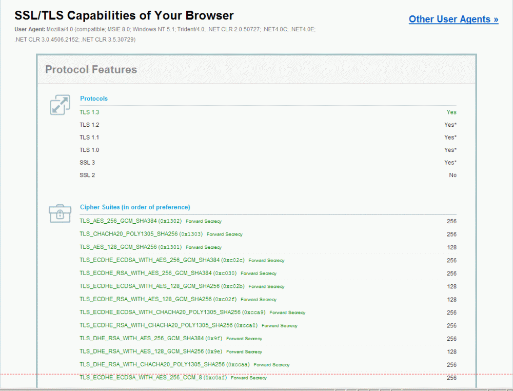

cmalex Posted July 15, 2022 Posted July 15, 2022 (edited) Greetings. 16 hours ago, AstroSkipper said: I could see that TLS 1.0 and 1.1 protocol was disabled. Take a look at my screenshots some posts above! Yes, i see that. But on my screenshots same version with IE8 give me SSL3 TLS1.0 TLS1.1 enabled. And wget also can see SSL3 wget.warc.gz - result of command 'wget -e "https_proxy=127.0.0.1:8079" "https://clienttest.ssllabs.com:8443/ssltest/viewMyClient.html" --no-check-certificate --warc-file=wget' I can't find old mails with descriptions - so much easiest solution is to recompile cryptography 3.4.8 with new OpenSSL3.0.5. 3proxy can use much more ciphers. ProxHTTPSProxy.EXE - launcher based on pip scripts - it just call python37.exe and import ProxHTTPSProxy.py sslproxies2.7z - full ProxyMII and 3proxy with upgraded openssl (3.0.0 -> 3.0.5), cryptography (3.3.2 -> 3.4.8), created ProxHTTPSProxy.exe, small changes in directory structure. Best regards. UPD. And forgot to say - my main comp is verified GMOSSE2-free :-). So it all works on non-SSE2 CPU. wget.warc.gz Edited July 16, 2022 by cmalex Links temporarly removed due to inproper license filling. 3

AstroSkipper Posted July 15, 2022 Author Posted July 15, 2022 (edited) @cmalex has recompiled the proxy ProxyMII, and it is now based on openssl 3.0.5 and cryptography 3.4.8. I've tested this new release in New Moon 28.10.6a1 (:2022-07-06) and here are my results. The first screenshot is the result on the website of Qualys SSL Labs - Projects / SSL Client Test: The second screenshot is the result of SSL/TLS Client Security Test on the website BrowserLeaks.com: As you can see, it works perfectly and both, TLS 1.0 and TLS 1.1, are enabled, too. This proxy provides all TLS protocols from TLS 1.0 to 1.3. It is the most recent ProxHTTPSProxy ever. Cheers, AstroSkipper Edited July 15, 2022 by AstroSkipper
