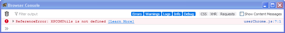

On 11/22/2024 at 7:55 PM, AstroSkipper said:
The download package MYPAL_68_CB_requirements.7z from my first post is actually working as it should. But I found in one file unnecessary code which was implemented by the original creator for enabling pre-Lion fullscreen mode mode under macOS. However, this code inside the file userChrome.js spits out an error in the Browser Console under Windows XP, which I could fix in two different ways. The most simple one is to remove this code since Mypal 68 targets the Windows OSes. The other one is to add some missing code which I also did just for fun. But as I already said, this is actually nonsense. Anyway! Here is the error when using the original userChrome.js file:
And here is a screenshot after removing code from the original userChrome.js file and restarting the browser:
You can see the message "ReferenceError: XPCOMUtils is not defined" has gone. :P After some weeks of testing, I can confirm that all is working perfectly. :thumbup If you are interested in and want to also do the fix manually, then you can do it as follows:
Old content of the userChrome.js file:
// Copyright (c) 2017 Haggai Nuchi
// Available for use under the MIT License:
// https://opensource.org/licenses/MIT
// Set "useLionFullScreen" in the same way that it's done in
// chrome://browser/content/browser-fullScreenAndPointerLock.js
XPCOMUtils.defineLazyGetter(FullScreen, "useLionFullScreen", function() {
    return false;
New content of the userChrome.js file:
