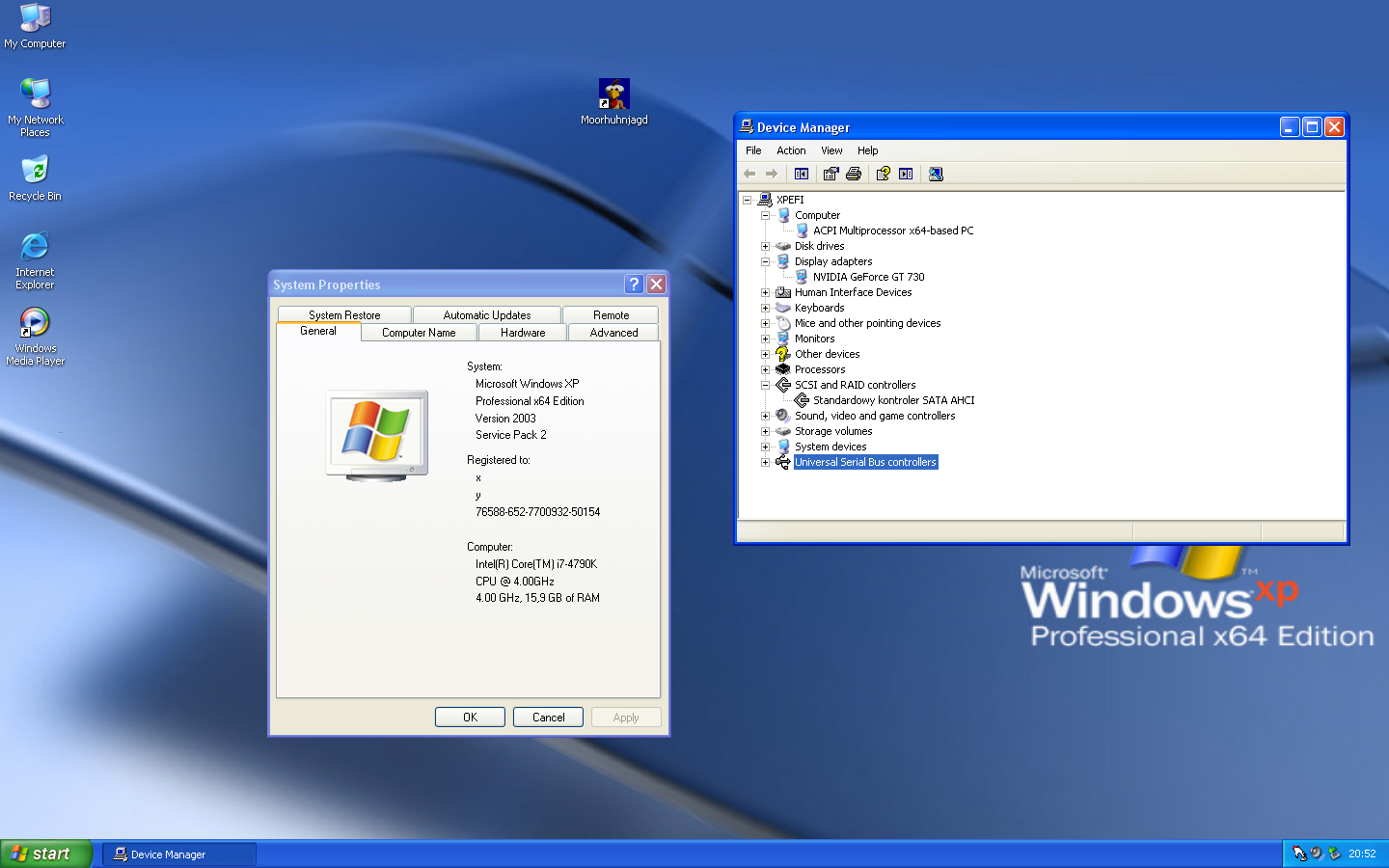

Here comes pic from XP SP2 bit64 on GPT harddisk on pur UEFI with working(!) graphik,
nice work from Gelip @reboot12
waaoohh..:cheerleader::cheerleader::cheerleader:
Dietmar
Edited by Dietmar
