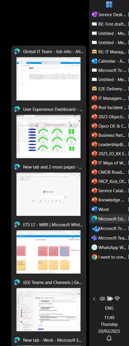

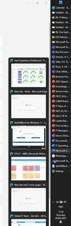

Issue report - Incorrect preview of combined windows when changing screen scaling
I use taskbar vertically aligned on the right side. When Settings > System > Display > Scale changes because of connecting to external monitor, the combined taskbar buttons preview does not properly show the open windows - see attached examples. There is a number of open Internet Explorer windows, but they don't fit all on the screen in preview.
To reproduce the issue
1) Set screen scaling to eg 125%
2) Open many windows, so that they start getting combined on the task bar
3) Change screen scaling to eg 150 or 100%, but so that the windows are still combined
4) Try to preview the windows combined under one tasbar button
Very often you'll get incomplete view like in the images attached.

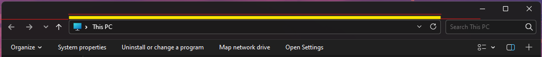

Hi everyone.
I've a question for the developer:
Is it possible to increase the area where the window can be dragged with the mouse?
As you can see in the screenshot, I am using the Windows 7 style Explorer with compact view (but the problem is also present in the non-compact setting).
The problem that annoys me - because I often misclick here -  is that there is an area above the address bar where the window can't be dragged with the mouse. (I marked this area with the yellow bar, the area above the red lines can be dragged.)
So, it it possible for startallback to fix that?
On 3/20/2025 at 1:37 PM, S7rUww3lP373R said:
Hi everyone.
Registry:
HKEY_CURRENT_USER\Control Panel\Desktop\WindowMetrics
REG_SZ = "CaptionHeight"
Value formula =
-15*desired height in pixels
(so for 15 pixel height of titlebar, value would = -225)
