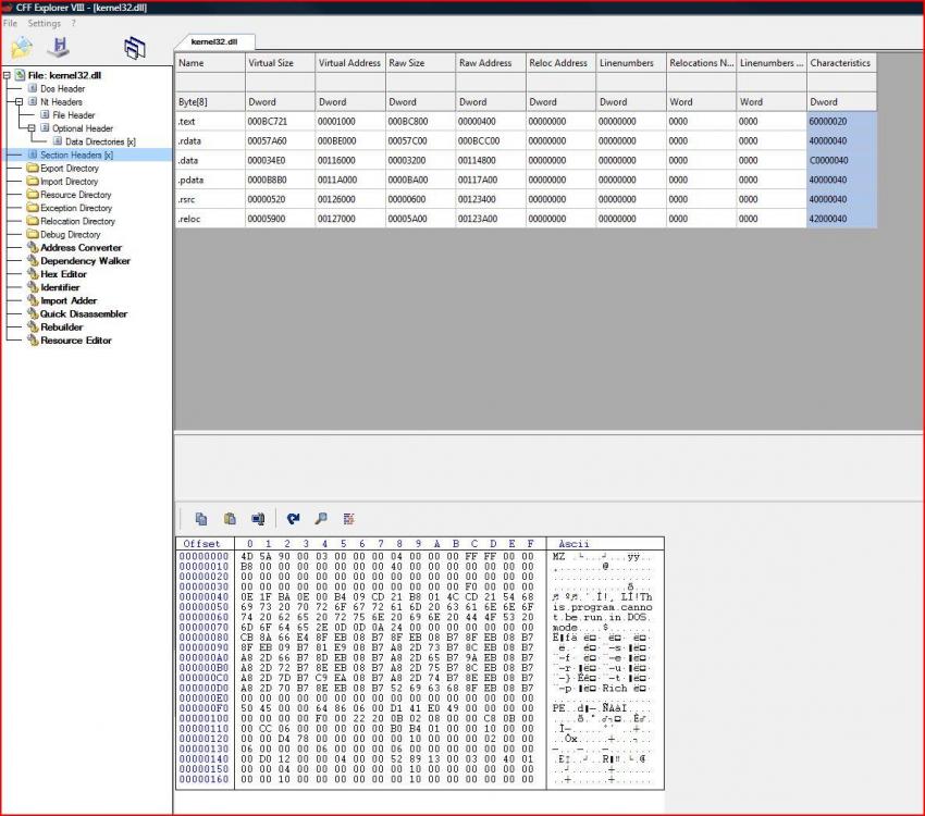

I opened up the firefox.exe file in  CFF Explorer and set the entry point in ntdll.dll from RtlQueryPerformanceCounter to NtQueryInformationProcess
There's your fix

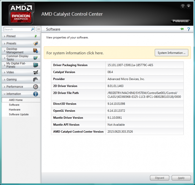

Another thing I discovered is that @greenhillmaniac's 15.101 driver works without any dll replacing, so this might help with making newer AMD drivers work. Will try 15.7 soon
  • Author
That's because of those user32 functions I added. But I haven't touched powerprof.dll, which apparently caused problems as well.

I modified shell32.dll since I decided to change some icons however, I think it removed certain functions since Firefox kept crashing afterwards. I re applied the original extended kernel shell32.dll and it worked perfectly fine just llike before. I'm definitely sure that I modified the extended kernel shell32. I don't know the cause of this. I used resource hacker to modify the dll file to replace icons and manually change the file copy animation color.
That may be because I put my new code and export table below the rsrc/reloc sections, which doesn't correspond to MS convention, yet seems to the easiest way to do it on x64. I'm gonna have to check out whatever reshack does to these files myself.

Powerprof appears to only cause issues with CCC
Looks to be this missing function that the 15.6 CCC uses, but it does open fine after the error, so idk
CCC from 15.6, and @greenhillmaniac's 15.101 driver

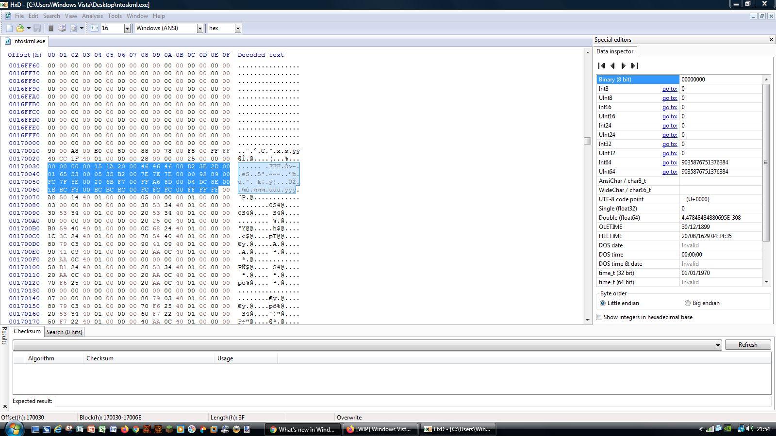

Well I've found the string
I'm a little stuck at this point since I haven't had a lot of experience
This is to do with the windows vista boot animation color BTW.
  • Author
That's the right string, but you will have to look at the three green colours, 01 65 53, 00 92 89 and 04 DC 8E. In RGB colour values, those are 083 101 001, 137 146 000 and 142 220 004 respectively.
So look for the RGB values for the shades of pink you want to use, reverse them and convert to hex. Then replace those three values in the string.
You should probably copy your ntoskrnl and give it a different name like ntkrnlmp.exe.
And then
bcdedit /copy {current} /d "Windows Vista Custom Boot Screen"
And then remember the long number/ GUID value that you get from this message:
"The entry was successfully copied to {01234567-89ab-cdef-00ff-fff000ffffff}" (for example)
so you can do this:
bcdedit /set {01234567-89ab-cdef-00ff-fff000ffffff} kernel ntkrnlmp.exe
And then there is the code signing enforcement that Vista and up introduces. I made a cracked ntoskrnl for that purpose, but you may also want to do this:
bcdedit /set {01234567-89ab-cdef-00ff-fff000ffffff} nointegritychecks 1
