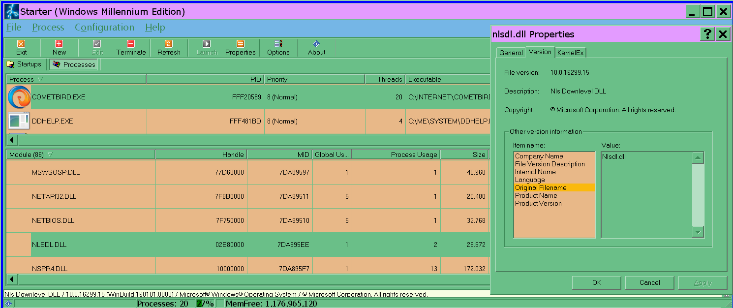

Try LocaleNameToLCID=>KERNEL32:ConvertDefaultLocale that will partially do the conversion and it will probably be OK. NLSDL should have worked with KEX disabled but it did not so try NLSDL Win10 with LocaleNameToLCID=>KERNEL32:ConvertDefaultLocale. BTW I use Dibya's ExKernel now but before I was using NLSDL and it was working with Cometbird9 and also KernelEx logging. I have done what I said with Win10 NSLDL above and it works see picture. Also if that does not work then perhaps returning the LCID with GetUserDefaultLCID or GetSystemDefaultLCID from Kernel32 for LocaleNameToLCID.

NLSDL Win10 seems to load, but thats a bit strange:
NLSDL of XP or 7 has no module warnings or error images.
