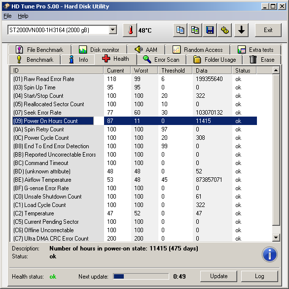

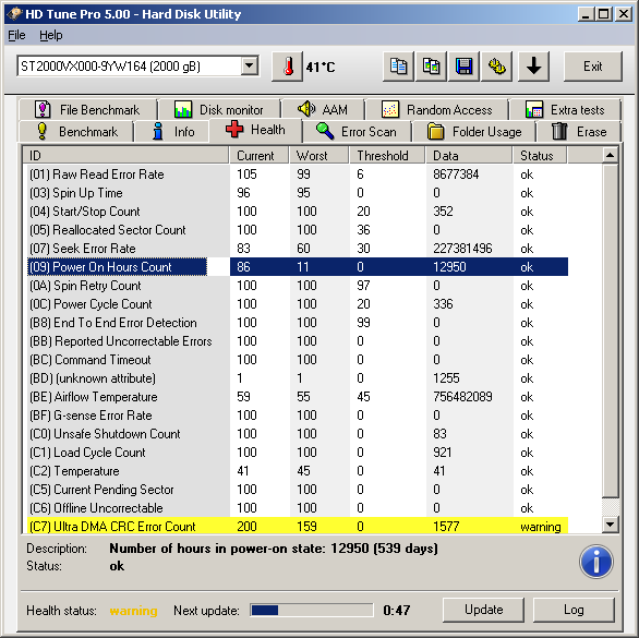

My oldest disks now have 140,000 hours. The counters for ST2000VN and ST200VX have reset again! You can see that the current percentage rating is 86 and the worst it has ever been is 11. They don't seem to want to enter a leaderboard?
The error count is from a bad cable (ST3320) and use of the HDAT2 tool (ST2000) where DMA was not correctly implemented.
I haven't caught that moment. If I did, I might have a clue what caused it. If the scale was linear (excluding that it stops at 1), then a rating of 11 would put the counter at 76-82 thousand, which is over the 16-bit mark. The other values of seeks/errors done are happily holding 34 bits, and the temperature is two fields packed with something in bits 37-33.
High-fly writes (0xBD) also seems to top out at 1. It seems to be a strict statistic, but hasn't caused problems yet.
Edited by j7n
