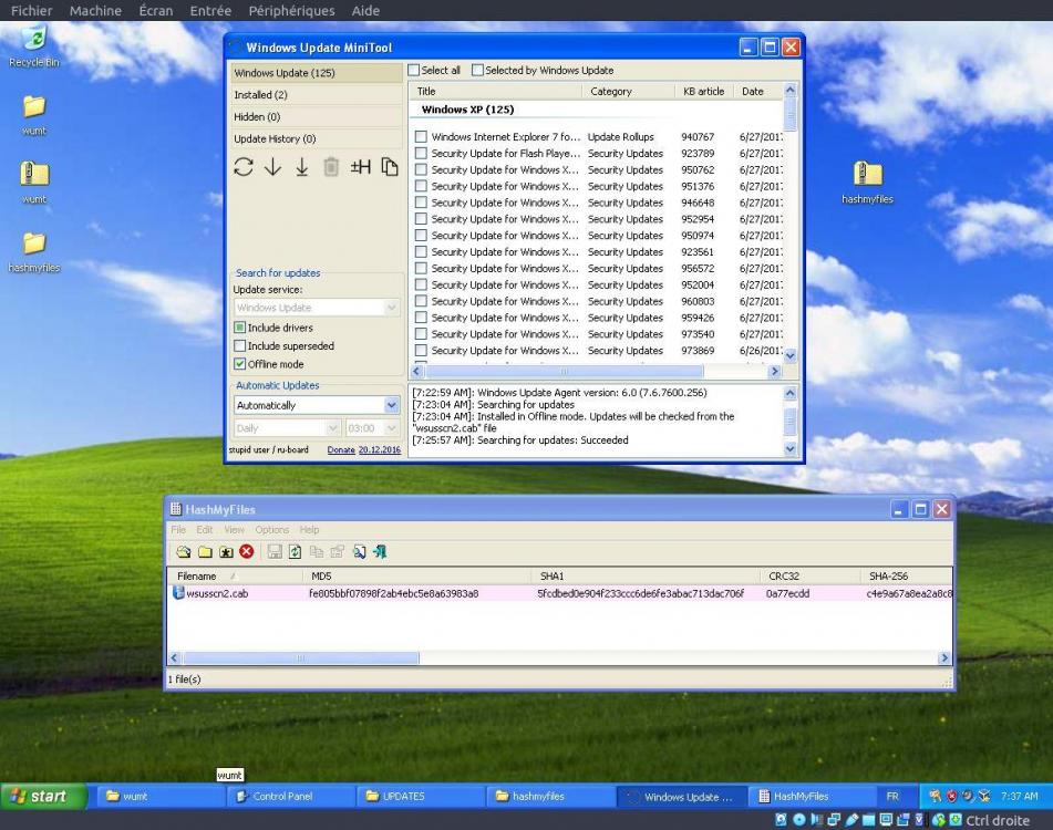

max-h Posted August 23, 2020 Posted August 23, 2020 (edited) 2 hours ago, Tomcat76 said: As Dave-H, I can't get this to work with WUMT. I'm using WUMT 20.12.2016 on Windows XP SP3 (POS Ready 2009). I renamed the cab to wsusscn2.cab and placed it in the same folder as the WUMT executable. Error message: An error has occurred: 0x800B0100 No signature was present in the subject I wanted to try this with WSUS Offline Update 11.9.1 ESR, but I can't figure out where I'm supposed to put the cab file, and if additional steps need to be taken as the official documentation specifies the program is downloading and using the cab from Microsoft or from Github. Same error here. I have tried updating the root certificates and it looks like there is a report because without it I get error 800B0003 "the form specified for the subject is not supported or known by the specified trust provider" and after 800B0100 like you and Dave. In my case I downloaded archive.org version from December 2019 and it worked : https://web.archive.org/web/20191209214827/http://download.windowsupdate.com/microsoftupdate/v6/wsusscan/wsusscn2.cab For Wsusoffilne, wsusscn2.cab is in client/wsus but when the process is launch it's erase the file, so... unusable. Edited August 23, 2020 by max-h

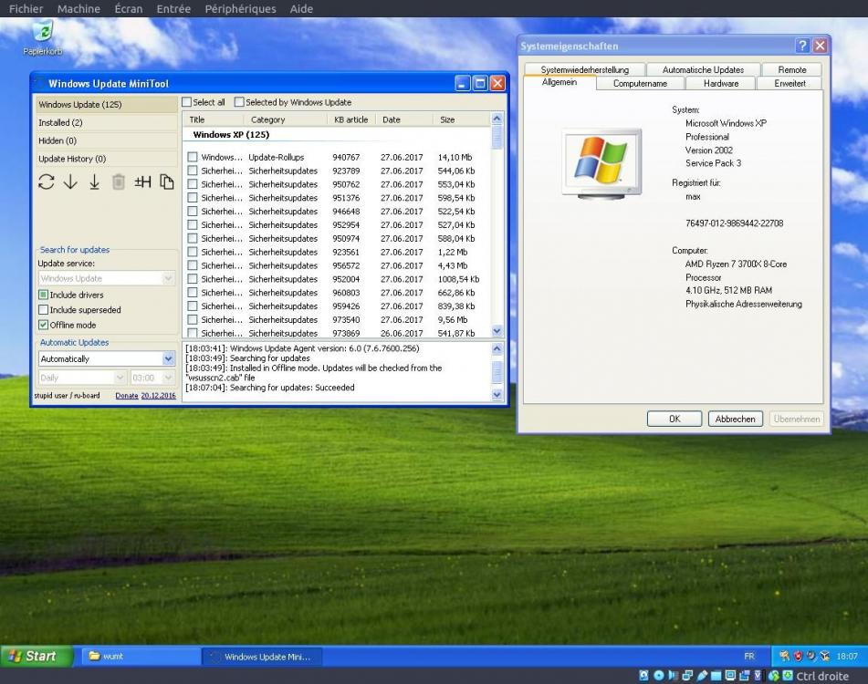

max-h Posted August 24, 2020 Posted August 24, 2020 (edited) Very very strange. To make sure, I tested with the US version of XP and guess what? It works with the July 2020 cab! So there would be a problem with all XP versions other than US? Edited August 24, 2020 by max-h

max-h Posted August 24, 2020 Posted August 24, 2020 You're right. I tested the German version after that and it worked too... What wrong with the French Version?
