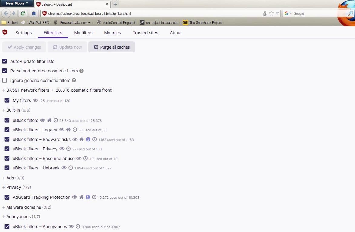

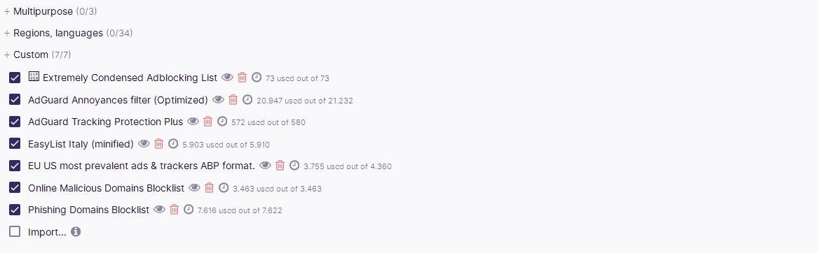

Sampei.Nihira Posted January 5, 2021 Share Posted January 5, 2021 (edited) Probably my final configuration: Edited January 5, 2021 by Sampei.Nihira 2 Link to comment Share on other sites More sharing options...

Vistaboy Posted January 7, 2021 Share Posted January 7, 2021 On 1/5/2021 at 12:40 PM, Sampei.Nihira said: Probably my final configuration: Please Sampei, can you tell why Ads (0/3)? Link to comment Share on other sites More sharing options...
Sampei.Nihira Posted January 7, 2021 Share Posted January 7, 2021 (edited) 7 hours ago, Vistaboy said: Please Sampei, can you tell why Ads (0/3)? I have two custom lists that are more efficient than the predefined ones: 1) Extremely Condensed Adblocking List Quote Originally made as a proof-of-concept to see how few entries that a modern-day adblocker would need to block ads, this list aims for at least 90% of EasyList's coverage with less than 0.1% as many entries. 2) EU US most prevalent ads & trackers ABP format Quote This blocklist is based on surveys of most used advertising and tracking technology (e.g. surveys of W3C, W3Tech and the on-line marketing community itself). These tech surveys are held once a year. This is the reason of the low update frequency (365 days and ad hoc corrections to correct website breakage). The surveys are oriented on Europe and North America, this is the reason this blocklist contains mostly EU and US based advertising and tracking networks. In advertising the number one (Google) has a marketshare of around 40 percent, Facebook the number two hits the 20 percent mark while the number three Comscore just has a little over 2.5% marketshare. For comparison Amazon with its huge webstore generates about the same advertising traffic on its own website. Number 100 on this list is probably used at 5000 websites of the Alexa Top 300.000 websites, while number 250 may only track you on 500 websites of the Alexa Top 300.000. When you decide to use this filter, it is good practice to add you language specific Easylist filter. Language specific filters often contain specific block and hide rules of the websites you visit (first party). This blocklist aims to block advertising and tracking networks which are used on the websites you visit (third-party). That is why they supplement each other well. And as you can see I have also entered the specific language list: 2A) EasyList Italy (minified) These lists are more than enough to stop ADS. Note that I also use Noscript. Those who don't use Noscript can set uBlock Origin in medium mode. To get an ADS block with identical effect. Edited January 7, 2021 by Sampei.Nihira 2 Link to comment Share on other sites More sharing options...
Vistaboy Posted January 7, 2021 Share Posted January 7, 2021 2 hours ago, Sampei.Nihira said: I have two custom lists that are more efficient than the predefined ones: 1) Extremely Condensed Adblocking List 2) EU US most prevalent ads & trackers ABP format And as you can see I have also entered the specific language list: 2A) EasyList Italy (minified) These lists are more than enough to stop ADS. Note that I also use Noscript. Those who don't use Noscript can set uBlock Origin in medium mode. To get an ADS block with identical effect. Thanks for detailed answer. I think you're perfectly right on positive effects of decreasing adblock entries for a smooth efficitent web browsing, but the next warning (not cited) quote of Extremely Condensed Adblocking List: Quote Beware that this list doesn't have nearly as good coverage against malware sites as what EasyList has let me think that for an old OS like XP (moreover whose source code getting leaked) it's maybe little better to give priority to safety at the expense of efficiency adblock listing. But in W7-W10 scenario your choice it's really worth of implementing. 1 Link to comment Share on other sites More sharing options...
Sampei.Nihira Posted January 7, 2021 Share Posted January 7, 2021 (edited) EasyList does not have a malware tag in the Filterlist. Just do a simple search by Tags. The purpose of the list is to block ads: If the blocking of ads also prevents the opening of pop-ups with possible malware content as a secondary effect, this decreases in value for those who use the Kees1958 list + Noscript. As you can see in my custom lists there are antiphishing and antimalwares lists as well. And in "my filters" I use my very personal Spamhaus list of 17 rules compared to the default of 10. Not to mention the rule: ||HTTP://*^$third-party,~stylesheet,~media,~image This simple single rule blocks all third-party requests (including XMLHTTPrequest, WebSocket, WebRTC, Ping, Object and ObjectSubrequests and Other e.g. beacons), so it provides more protection than uB0 medium mode protection which ‘only’ blocks third-party scripts and (i)frames (subdocuments in AdBlockPlus syntax). It is possible to calculate today that the simple rule above alone blocks at least 30-40% of malicious websites. I believe I am sufficiently protected even in a W.XP OS if we consider that uBlock Origin is only a small part of my security configuration. Edited January 7, 2021 by Sampei.Nihira 3 Link to comment Share on other sites More sharing options...
Vistaboy Posted January 8, 2021 Share Posted January 8, 2021 On 1/7/2021 at 8:32 PM, Sampei.Nihira said: If the blocking of ads also prevents the opening of pop-ups with possible malware content as a secondary effect, this decreases in value for those who use the Kees1958 list + Noscript. Not to mention the rule: ||HTTP://*^$third-party,~stylesheet,~media,~image This simple single rule blocks all third-party requests (including XMLHTTPrequest, WebSocket, WebRTC, Ping, Object and ObjectSubrequests and Other e.g. beacons), so it provides more protection than uB0 medium mode protection which ‘only’ blocks third-party scripts and (i)frames (subdocuments in AdBlockPlus syntax). It is possible to calculate today that the simple rule above alone blocks at least 30-40% of malicious websites. I believe I am sufficiently protected even in a W.XP OS if we consider that uBlock Origin is only a small part of my security configuration. My fault, never fallen in love with Noscript because of his aggressivity and tricky learning curve But i've borrowed that great rule, applied and saved it in a uBlock backup folder for future reference Link to comment Share on other sites More sharing options...

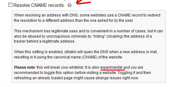

Sampei.Nihira Posted March 8, 2021 Share Posted March 8, 2021 (edited) Interesting article of some days ago: https://adguard.com/en/blog/cname-tracking.html Quote Browsers themselves can't protect users from CNAME-cloaked tracking. But content blockers can: AdGuard and AdGuard DNS, as well as uBO on Mozilla Firefox already block such "hidden trackers" UBO on Mozilla Firefox,but not UBO Legacy with New Moon, because only UBO >= version 1.25.0 has this feature. Quote Now we're making the full list of all known CNAME-cloaked trackers publicly available as a part of the AdGuard Tracking Protection Filter I therefore recommend that MSFN members enable this list in their UBO Legacy. Although it appears that Easy Privacy has recently included the same ( probably) CNAME list. Another way to get CNAME protection is to use AdGuard DNS. P.S. The ηMatrix extension also has a CNAME protection feature. But its reliability is to be proved Edited March 8, 2021 by Sampei.Nihira 2 Link to comment Share on other sites More sharing options...

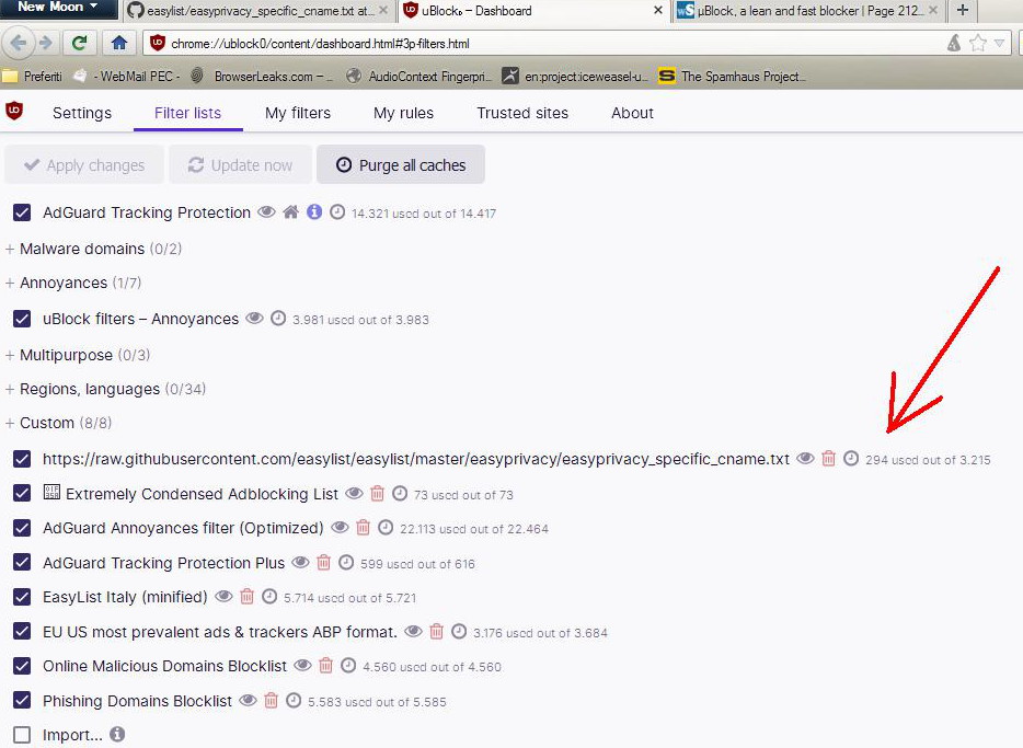

Sampei.Nihira Posted March 9, 2021 Share Posted March 9, 2021 (edited) https://github.com/easylist/easylist/blob/master/easyprivacy/easyprivacy_specific_cname.txt The CNAME list is now not included in the AdGuard Tracking Protection list. AdGuard Tracking Protection added the CNAME list from line 6189. Edited March 10, 2021 by Sampei.Nihira 2 Link to comment Share on other sites More sharing options...
Sampei.Nihira Posted March 9, 2021 Share Posted March 9, 2021 I tried to calculate the percentage of CNAME trackers blocking done by my lists in UBO Legacy. If the mathematical formula I used is correct: ((3215 -294)/3215)*100 = 90.86 % But I may have been wrong. Any MSFN member is free to correct my possible mistake. Link to comment Share on other sites More sharing options...
